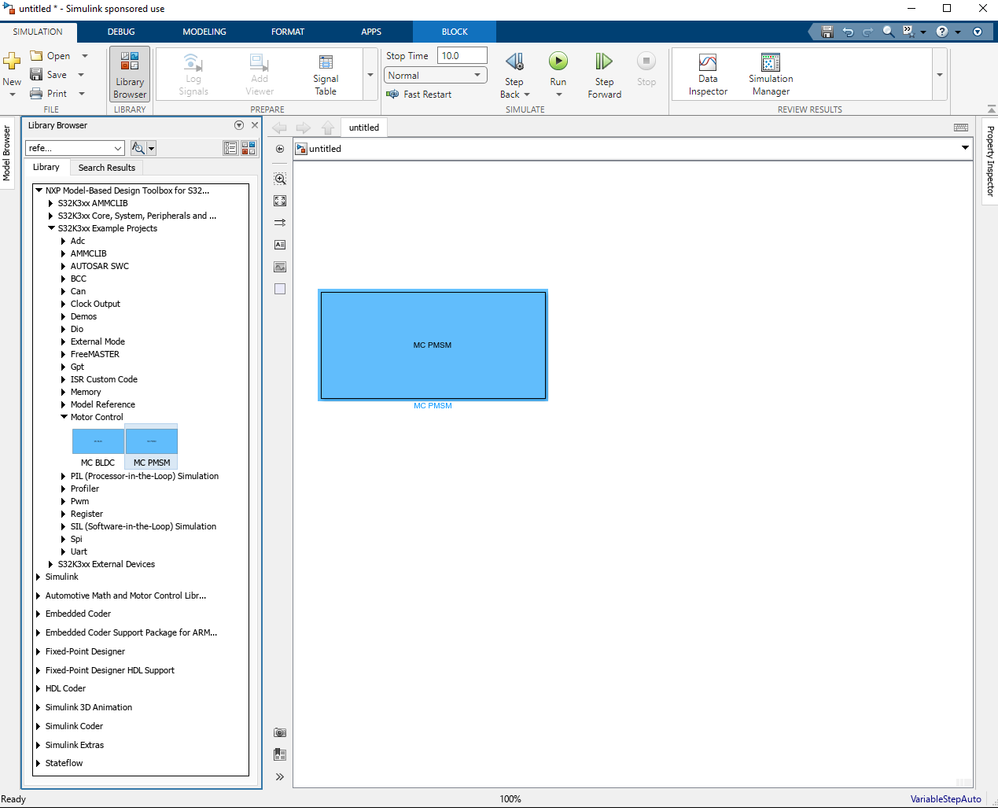

In the next step I have selected the PMSM Motor Control example from Simulink, using Library Browser.
Simulink ModelSimulink Model

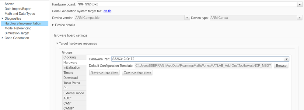

In the hardware-part selection window configuration, I chose the correct EVB, as you can see below, and the configuration process is using S32 Design Studio as the configuration tool instead of EB Tresos.
Hardware-Part SelectionHardware-Part Selection

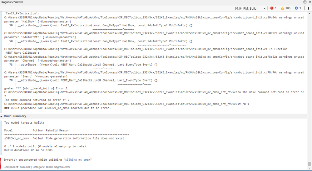

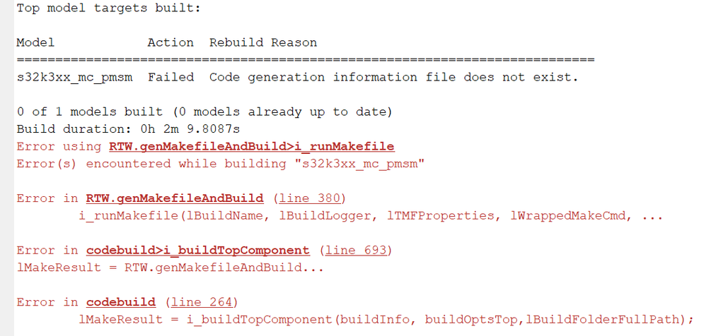

When I try to generate, build and deploy the Code into the EVB, during the build process, Simulink gives a rebuild reason and several errors as you can see below:
Code Generation Information file does not exist”:
Diagnostic ViewerDiagnostic Viewer
Error 1/2Error 1/2
Error 2/2Error 2/2

Please note that the PMSM example delivered within MBDT for S32K3 v1.2.0 is designed specifically for the S32K344-Q257 processor, having a EB Tresos custom configuration project associated to it. For more details on what MBDT custom or default configuration projects mean and how they are used for applications development, please check the details provided in this thread.
Now, to address the mentioned questions specifically:
1. MBDT for S32K3 uses the RTD delivered within the package for building the models and creating the executable files which are downloaded on the target. So, the step of building the model in the Simulink environment should not be affected by the packages installed in S32DS - they are independent application development environments.
2. If the other S32K312 examples were able to be built and downloaded on the target without any issues, then the problem you are facing might be related only to the PMSM example indeed.
3. As previously mentioned, I think that the error occurs because the PMSM example is designed specifically for the S32K344-Q257 part, using an EB Tresos configuration. When you change the Hardware Part - to S32K312-Q172 EVB, and also the configuration tool to S32CT, the default configuration project corresponding to this part (S32K312) will be used by the model. However, this S32K312 configuration does not contain all the setting necessary for a motor control application. Currently MBDT does not provide motor control examples on S32K312, hence, to fit the particularities of your application, you would need to update the project in the chosen external configuration tool.

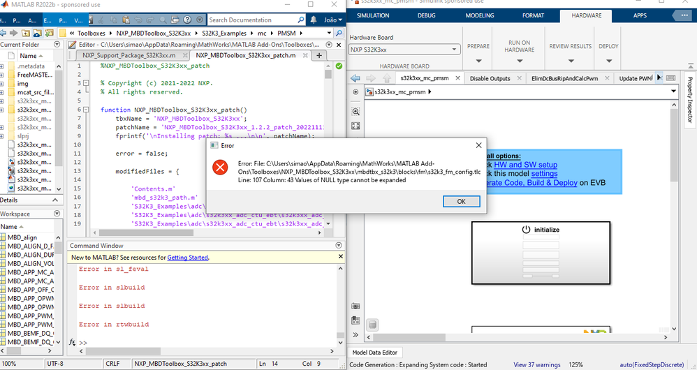

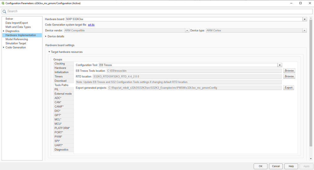

After your reply I tried to run again the PMSM example to be able to generate C code. Since the example is designed specifically for the S32K344-Q257 microcontroller, in the target hardware resources in simulink I selected that microprocessor as my target and EB tresos as the configuration tool as we can see in the following pictures:
After trying to generate and deploy the code in my EVB, I get the following error:

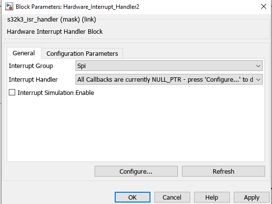

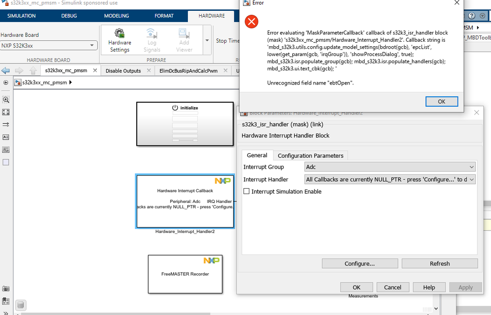

Next, I tried to open the configuration in EB tresos in order to change the configurations in the tool to see if it could solve my problem and an error that I got in the Block Parameters: "Hardware_Interrupt_Handler2" saying that all callbacks are NULL_PTR
EB tresos was able to open the project configuration, but after the use of the tool, we must refresh in order to update the configurations, and I got the following error:
 After the "ebtOpen" error show, I press ok, and simulink stays forever analyzing the Tresos Project as you can see:
I will also attach the log errors that I got from the MATLAB console.
In conclusion I cannot get the C code generated nor update the project configurations in EB tresos.
