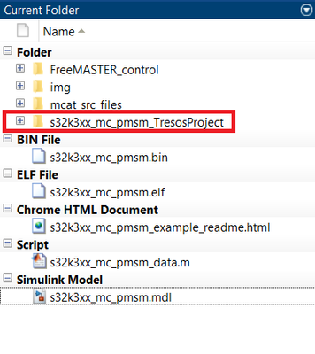

However, if the model is already delivered with an associated project (a TresosProject folder or a .mex file placed next to the model), that is the one that will be used during the build process for generating corresponding configuration code based on the enabled settings. The motor control examples we provide use such custom projects, as you can see in the picture below, highlighted in red.

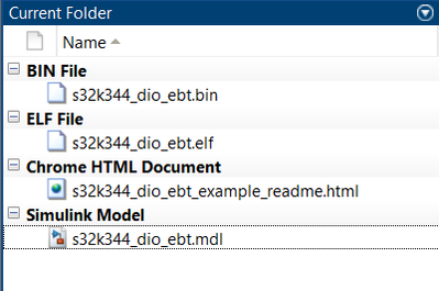

For a better understanding of when default or custom projects are used, you can check the Dio applications. For example, you can navigate to the S32K3_Examples/dio/s32k344_dio_ebt folder. As you can see, in this case, there is no project placed next to the model, hence the default configuration will be used when building this application.

The custom projects contain settings enabled to fit specific applications particularities, like motor control. When you change the configuration tool for the PMSM model (to S32 Configuration Tools), the custom project is not automatically translated into the new configuration tool. What happens is that the default S32 Config Tools project (not customized for motor control) will be used for the Simulink build process.
Since the model you are trying to build was designed based on the EB Tresos custom configuration placed next to it, the default S32 Configuration project will not contain all the settings (channels, hardware units, etc.) needed by the model, hence the build will fail.
Please also note that changing the Hardware Part will trigger the same behavior. The model is configured specifically for the S32K344-Q257 processor. If you change it to a different selection, the default configuration project (not customized for motor control) will be used for the following steps. A pop up dialog also informs you on this when you make the change.
Therefore, you could keep the custom project the toolbox provides for this example, install EB Tresos and use it as the Configuration Tool, leaving the model settings unaltered. In this way you could also take a look inside the s32k3xx_mc_pmsm_TresosProject configuration, and see how the components are set for such a specific application.

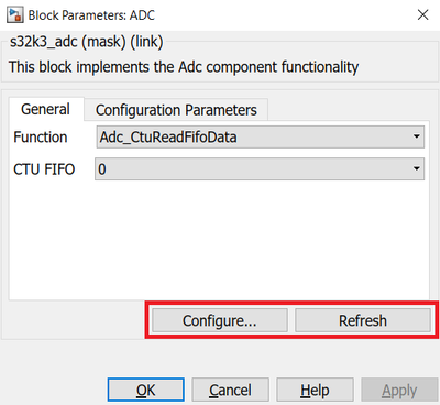

Unlimited Configuration Mode
Please also note that the toolbox also allows you to create your own custom projects. By pressing the Configure button of any of the blocks in the model, the configuration project found next to the model will open. Inside this environment you can make any changes you like for addressing the particularities of your application. Saving the project and going back to your model, the Refresh button will update the new settings into the Simulink environment.
In this way, you have complete flexibility of configuring the hardware you are using, according to the application you are designing.
