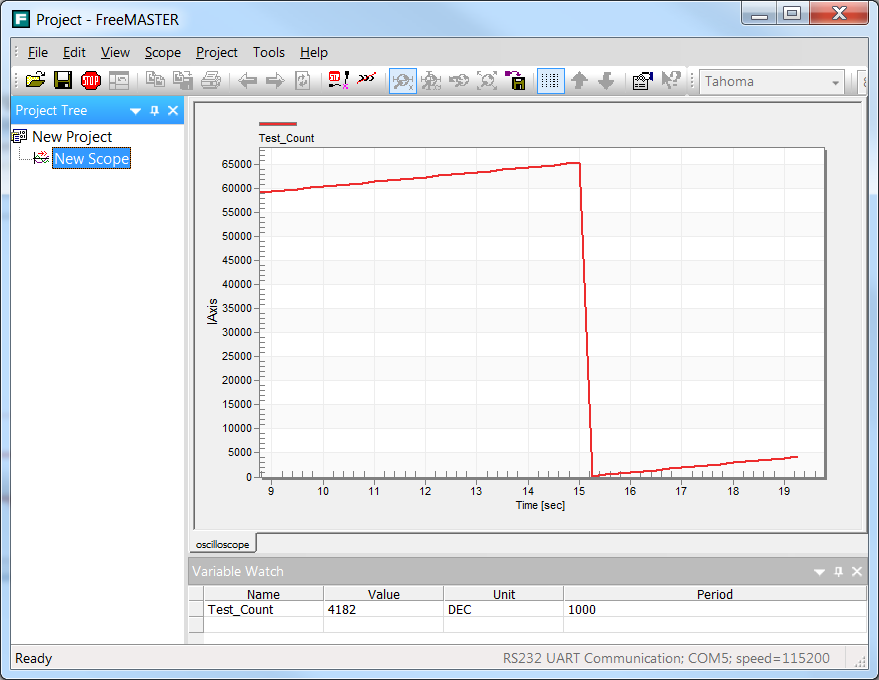

I’m currently on Lecture 10 (Open Loop with Speed Estimator) in your MPC5744P Model-Based BLDC Motor Control class, but I am stuck. It seems that in my Open Loop model, the PIT only fires 3 to 5 times at startup, and then stops (see attached FreeMASTER screenshot), and so the estimated speed is always zero.

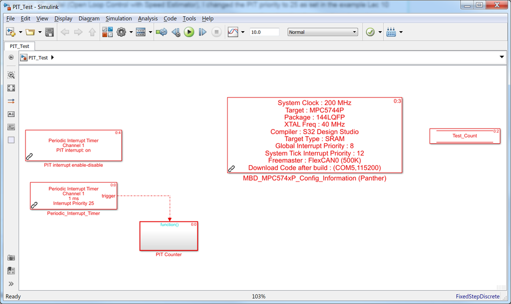

To double check the PIT, I created a new model that only has a PIT on Channel 1, and increments a variable every time it is called. The model and FreeMASTER screenshot is attached. As you can see, the Test_Count variable is never changed, so it seems as though the PIT never fires and the ISR is never invoked.
I checked the generated C source code files, and it looks like the PIT is getting initialized and called correctly. I also checked the intc_sw_vectable.c file (as per this issue, in which the poster’s description of the problem seems very similar), and the PIT ISRs are assigned the proper slots.

So I seemed to have fixed my issue. Somehow.
In my stand-alone PIT model that I attached, I added a test variable that always increments, and the PIT started working.
In my Lec 10 model (Open Loop Control with Speed Estimator), I changed the PIT priority to 25 as set in the example Lec 10 model file, but I did not add a test counter variable--and now it's working. It's correctly estimating the speed as shown in SPD_RPM.

It's a bit strange. I tried your original model on my setup (Matlab 2017a + MPC5744P DevKit) and it works fine.
As a hint - try to delete the generated folder from time to time. Sometimes the MATLAB with cache some of the files needed for code generation - and that might explain why it did not work.
