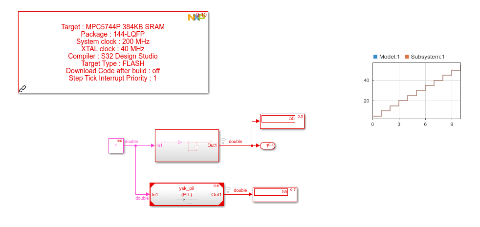

Unfortunately, because we are using a custom tlc file, running PIL requires inserting our config block in all the referenced models as well. This should not affect the simulation running for the referenced models. Once I've added the config block, the PIL ran.

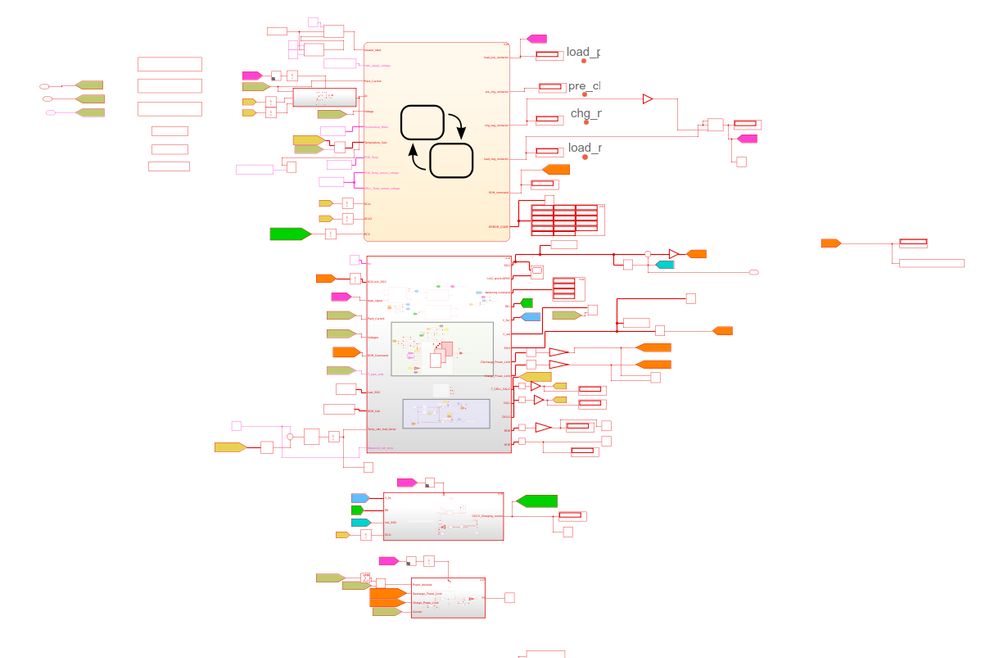

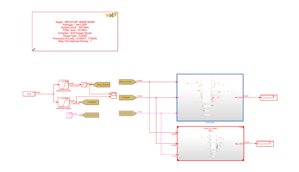

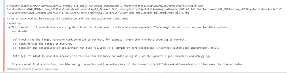

When I increased complexity and size of the model , It seems that I get a communication error. I am using same config and same model parameters. What may be the problem?
How can I solve that?
Thanks.
Inside of model:
PIL_VERIFICATTION:
RESULT:

ykarata1
Thank you very much mariuslucianandrei
I have added config file to the model and it has worked.
Thanks a lot. That was my first PIL experience. :smileygrin:
