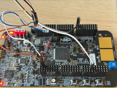

I am using an NXP S32K312 EVB with Simulink NXP MBDT Example - s32k3xx_i2c_async_s32ct.slx
I made sure to follow instructions - these pins are connected

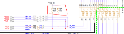

Looking at the last instruction, I checked the schematics of the EVB and it seems they have pullup resistors already, I was able to locate them on board as well. All jumpers are connected as mentioned in  S32K312EVB-Q172 - Hardware User Manual.
Build and flash - no issues observed.

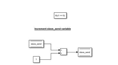

When I run FreeMASTER, I see no change on "slave_send" variable being changed at all. Does it something have to do with interrupt in this case, please confirm. I suspect this because, this is what increments the "slave_send" variable. Please let me know the steps to enable it. Attached is the .mex

Hi @beginner100
Can you provide a picture of your setup with the S32K312EVB-Q172 and the connections?
Just to be sure, have you connected the Pull-up resistors for pins PTD14 and PTD13 as in the picture below?
Just in case I have attached the s32k311_i2c_async_s32ct.zip that I have tested and it works on my S32K312EVB-Q172.
Please test it and send me all details and pictures,
Stefan V.

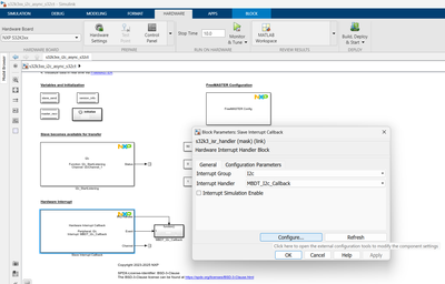

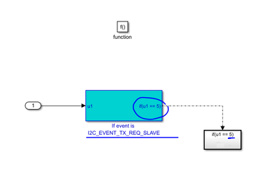

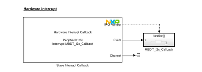

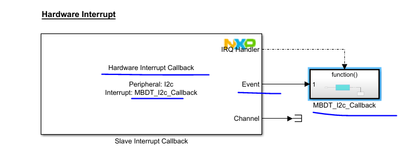

One more question on the same example and it's this event "I2C_SLAVE_EVENT_TX_REQ" within Hardware Interrupt Callback (MBDT_I2C_Callback)
Why is the Event output being compared to 5 ?  Is I2C_EVENT_TX_REQ_SLAVE defined as 5? Where can I find this configuration in the S32CT tool? What other events are available and can you please explain and help me understand this better, thank you!
6,554 Views
stefanvlad
Hi @beginner100 ,
There is a structure defined in the Lpi2c_Ip_Callbacks.h:
* @brief Define the enum of the events which can trigger I2C slave callback
* This enum should include the events for all platforms
* implements Lpi2c_Ip_SlaveEventType_enum
typedef enum
I2C_SLAVE_EVENT_ERROR_BIT = 0x00U,
I2C_SLAVE_EVENT_UNDERRUN = 0x01U,
I2C_SLAVE_EVENT_OVERRUN = 0x02U,
I2C_SLAVE_EVENT_RX_FULL = 0x03U,
I2C_SLAVE_EVENT_TX_EMPTY = 0x04U,
I2C_SLAVE_EVENT_TX_REQ = 0x05U,
I2C_SLAVE_EVENT_RX_REQ = 0x06U,
I2C_SLAVE_EVENT_STOP = 0x07U,
I2C_SLAVE_EVENT_DMA_TRANSFER_ERROR = 0x0EU
}Lpi2c_Ip_SlaveEventType;

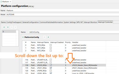

To open the S32 Configuration Tools, you need to select an NXP block, and press Configure:
Then when S32CT is opened, you can go to Platform in the Interrupt Controller, to locate the LPI2C0_Master_Slave_IRQHandler:
Stefan V.

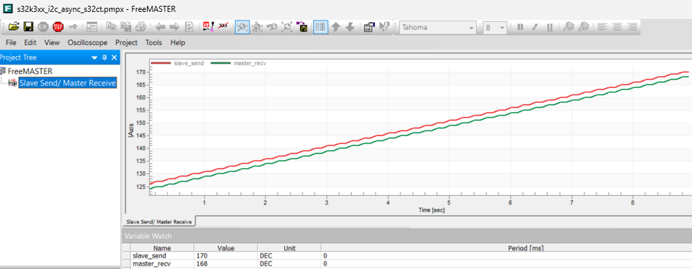

beginner100
I have used the model from the .zip shared, and now it seems to be working fine. Yes, I have also connected the resistors as you mentioned.

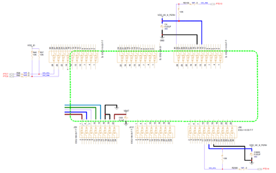

stefanvlad
Hi @beginner100 ,
Thank you for using MBDT for S32K3 with the S32K312EVB-Q172 evaluation board,
In the case of the s32k3xx_i2c_async_s32ct example, the table below describes the connections between the I2C instances on S32K312-Q172:
But in that help file, there is also a Note below that reads:
  • Note: When running this model on S32K311EVB-Q100, S32K312EVB-Q172 or S32K388EVB-Q289, please note that the signal lines used for the I2C transmission require external 2k Ohm pull-up resistors between SDA and VDD and SCL and VDD. For VDD, you can use the pin J40.9 for S32K311EVB-Q100, J39.13 for S32K312EVB-Q172 or J696.14 for S32K388EVB-Q289.
Because the other I2C Instance has pins PTD13, PTD14 with no pull-up resistors, you need to add those, and connect them, one example is in the picture below:
I have created a simplified version of the schematic showing only the I2C connections needed with pull-up resistors:
After you make all the connections , then you can open FreeMASTER and take a look at variables:
Both of them will increment accordingly and go up to 256 then roll back to 0.
Hope this helps you with the setup,
Stefan V.

beginner100
Thank you for the input, @stefanvlad.
I did make changes as suggested, on FreeMASTER i only see Slave_send as 0 and master_recv as 255. I do not see any ramp up or incrementing of values. Are there any other set of pins that can be chosen as the slave I2C Instance instead of PTD13, PTD14?
