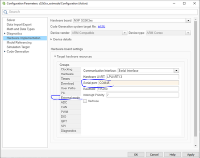

Thanks for the tip, I can upload to the controller. I'm having problems with putting the controller in external mode. This I presume is due to the COM port being configured  inaccurately since when I click "monitor and tune" the firmware uploads onto the board successfully via the OPENSDA micro-USB port. I cant find the COM port number in the device manager on my computer, neither does it automatically update in the model settings when I reconnect the eval board to the computer. Is this something you've experienced and do you know what steps I can take to remedy the problem?

mariuslucianand
Hello @kamalwolly
Indeed you have to specify the COM port associated with the board.
Let's have a look at the image above.
1 and 2 is the 12V power supply, in order to supply the board, you have to plug in a 12V jack and to turn the button until those 3 leds are lighting.
3 is the USB2Serial converter. You have to connect the USB port to be able to communicate with the board. In both PIL and External mode, you need this cable for the communication between MATLAB's host PC and the board.
4 is the internal debugger. You have to connect this cable to be able to flash the board.
Now, in your case, once you have connected cable 3, go to device manager, and see which ports have appeared. In my case, are the COMs 44 and 45. They are 2 because the board has a dual USB2Serial, thus 2 channels, and the LPUART13 of the MCU is connected to the FTDI's channel B. In most of cases, the channel B is connected to the COM with the higher number.
Not that we know the port, in my case is COM45 but it will be different on your side, go to Hardware Settings in Simulink, select External Mode and under Serial port type the new COM port, in my case COM45.
Hope this helps,
Marius

kamalwolly
worked like magic, I've got two more problems and hopefully I should be good to go,
Firstly, I can only Monitor and tune the external mode  example provided by NXP, whenever I try to do that with any other example or projects I have created that builds and deploys. It brings up an error that COM 1 fails to open when I've clearly setup com 32 for external mode  (Image below)

Irina_Costachescu
Hi @kamalwolly
Related to the External Mode issue, can you please indicate which Matlab version you are using?
As a suggestion, you could try setting the same COM port in both the External Mode and PIL groups from the Hardware Settings. Additionally, in case this does not provide the expected behavior, try by enabling also the Verbose option in the External Mode group.
Irina
33,696 次查看
kamalwolly
my MATLAB version is 2021a, I've attempted both solutions you suggested, the firmware does download onto the hardware, it just fails to initialize the external mode.
