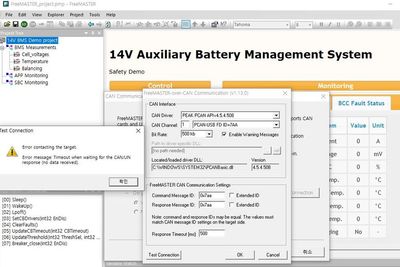

Several actions could be checked through UART communication. However, CAN communication is not connected.
I am getting an error as shown below.
Please answer the two questions below. (Please help me...)

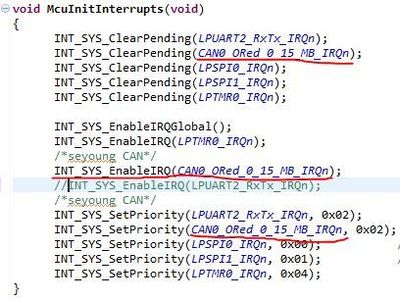

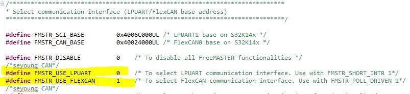

1. The source part I changed is as follows.
Are there any additional changes that need to be made?
(I am using S32 Design Studio for ARM Version: 2018.R1.)
main.c (line 113)
peripherals_init.c (line 88)
freemaster_cfg.h (line 25)

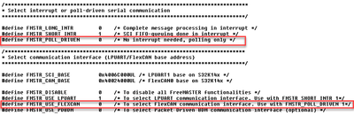

1.
It says that if you are going to use CAN, FMSTR_POLL_DRIVEN should be configured to '1'. So, no interrupts are needed.
