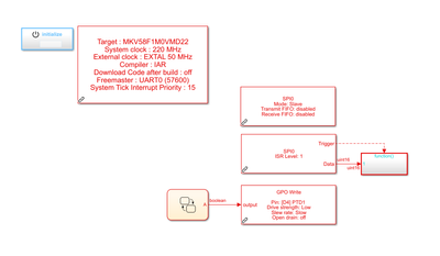

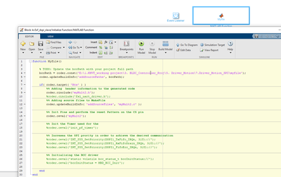

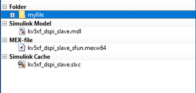

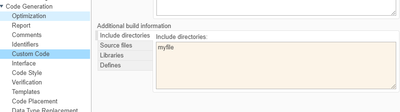

Dear NXP support,
Currently, I am using MCD toolbox to buil my application. I had embedded a custom code for the application, but I had an error while build project.
I am using IAR compiler

My code was build successfully without custom code. The previous version has many component than current version. Therefore, I prefer use it to my application.

Hi, I saw a function related with custom is mcd_copy function. But I don't see any examples or help to clarify to use this one. Can you give a example for using this function? Currently, I am still using MCDT for my project. I hope you can update current mbdt package to have full function.
Thank you.
