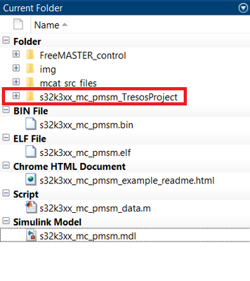

The MBDT for S32K3 uses the integration of external tools (EB Tresos or S32 Config Tools) for configuring the hardware for a specific application (peripherals, pins, clocks). The toolbox provides a default configuration (available both in EBT or S32 Config Tools), enabling all the components we offer support for, for each of the supported processors. Such a default configuration is used during the build of Simulink models, being a folder in case of EB Tresos, identified as modelName_TresosProject, or a file, identified as modelNameConfig.mex in case of the S32 Configuration Tools selection.
However, if the model is already delivered with an associated project (a TresosProject folder or a .mex file placed next to the model), that is the one that will be used during the build process for generating corresponding configuration code based on the enabled settings. The motor control examples we provide use such custom projects, as you can see in the picture below, highlighted in red.
For a better understanding of when default or custom projects are used, you can check the Dio applications. For example, you can navigate to the S32K3_Examples/dio/s32k344_dio_ebt folder. As you can see, in this case, there is no project placed next to the model, hence the default configuration will be used when building this application.
Motor Control Custom Configuration Projects

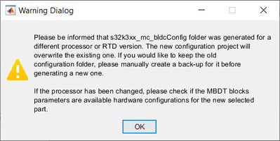

The custom projects contain settings enabled to fit specific applications particularities, like motor control. When you change the configuration tool for the PMSM model (to S32 Configuration Tools), the custom project is not automatically translated into the new configuration tool. What happens is that the default S32 Config Tools project (not customized for motor control) will be used for the Simulink build process.
Since the model you are trying to build was designed based on the EB Tresos custom configuration placed next to it, the default S32 Configuration project will not contain all the settings (channels, hardware units, etc.) needed by the model, hence the build will fail.
Please also note that changing the Hardware Part will trigger the same behavior. The model is configured specifically for the S32K344-Q257 processor. If you change it to a different selection, the default configuration project (not customized for motor control) will be used for the following steps. A pop up dialog also informs you on this when you make the change.
Therefore, you could keep the custom project the toolbox provides for this example, install EB Tresos and use it as the Configuration Tool, leaving the model settings unaltered. In this way you could also take a look inside the s32k3xx_mc_pmsm_TresosProject configuration, and see how the components are set for such a specific application.
