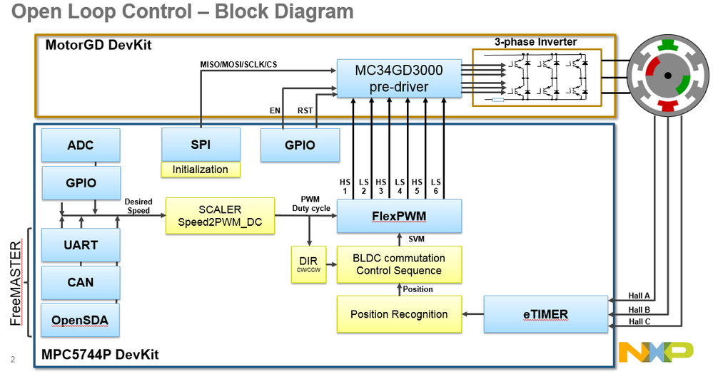

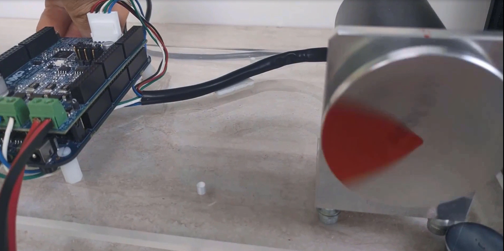

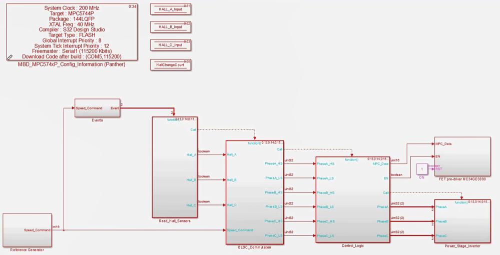

In this 9th lecture of the motor control course we discuss open loop control system and how to build a Simulink model to allow us to control the BLDC motor without closing the speed control loop. We start from the models developed in previous lecture and by putting together all these models we will spin up for the first time the BLDC motor based on Hall sensor commutation.
Main topics:
    - What is Open Loop Control system and how is it different from a Closed Loop Speed Control system ;
    - Build the Simulink model for Open Loop control of BLDC motor;

OK thank you dumitru-daniel.popa , progress!  I now have the motor spinning and can connect with Freemaster after making the changes in the link above.
I want to mention that the connection of the motor phases that works on my system does not match the instructions.  For me the following connections work (using a Linix 45ZWN24-40).    I ran my own manual test using (A:White, B: Blue, C: Green) and observed the same hall states as implemented in the model, yet the motor performance was very poor until connecting as indicated below.  I welcome comments/analysis on this observation.
Motor:
PHA : BLUE
PHB: GRN
PHC: WHT

I have a question/problem: When running the code generated by this example, it appears that the power stage becomes disabled when Freemaster connects to the target.  Any ideas why, and what to do to get the power stage re-enabled?  Also, why are some model variables not visible in Freemaster?  (For example, "PhaseA", "EN", etc)
14,967 Views
darrin_weiss
More info. It seems that the EN and RST lines have constant glitching when Freemaster is connected.  Is there a setting to prevent this?
