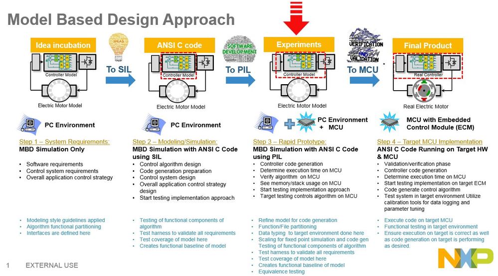

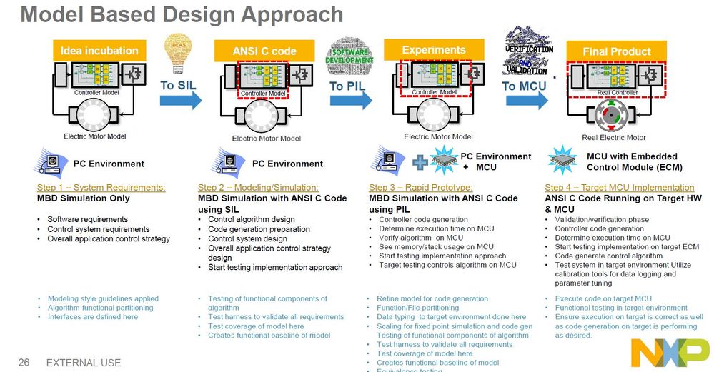

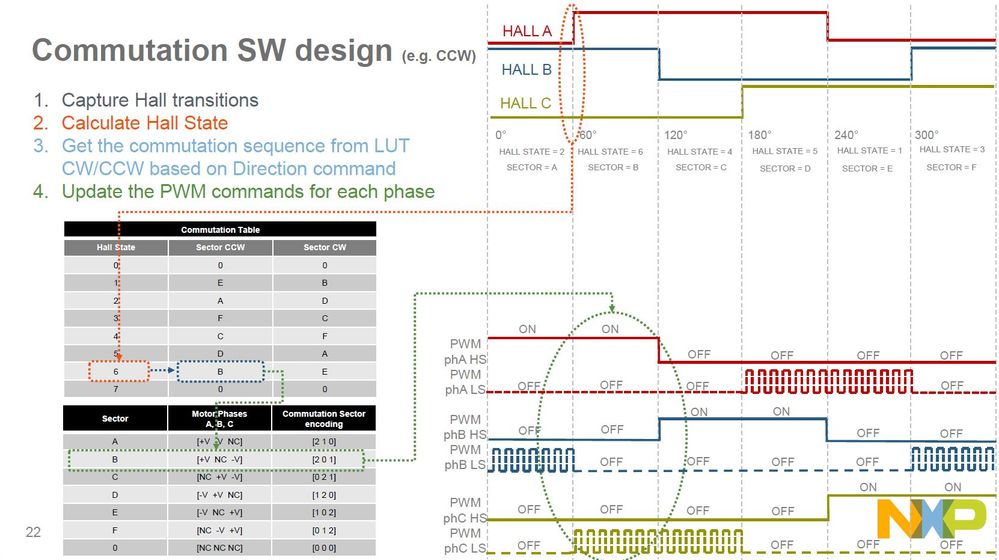

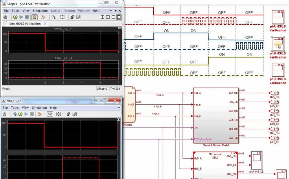

In this 7th lecture of the motor control course we discuss about how can we implement the software algorithm for rotating the motor in clockwise or counter clockwise directions. After algorithm implementation we are going to set the model using Software-in-the-Loop (SIL) and Processor-in-the-Loop (PIL) simulation for testing and validation.
Main topics:

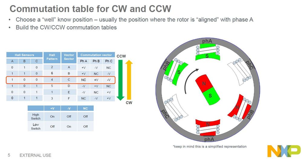

    - How the commutation tables are implemented;
    - How to define the requirements for the software algorithm;
    - How to implement the commutation software algorithm;

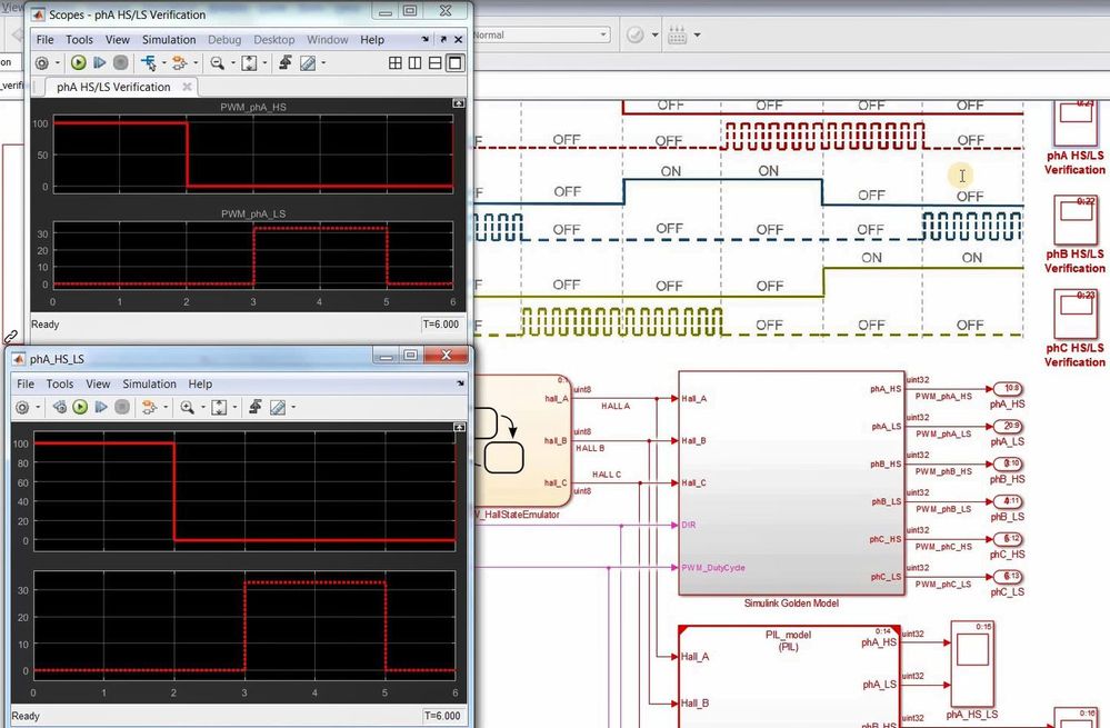

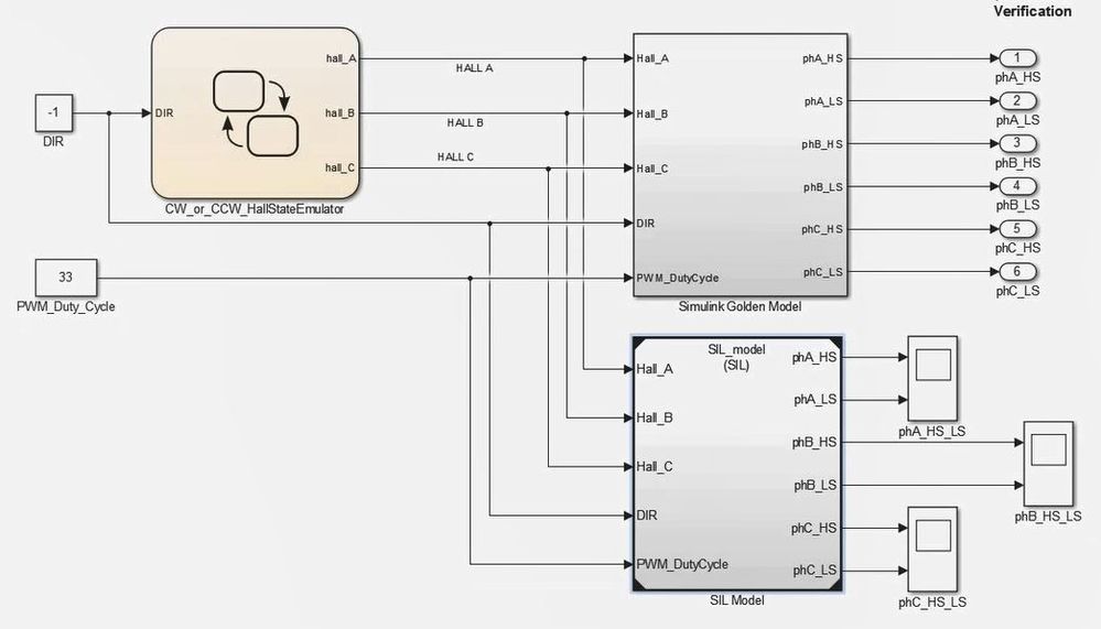

    - How to use Software-in-the-Loop (SIL) for algorithm testing and validation;
    - How to use Processor-in-the-Loop (PIL) for algorithm testing and validation;
Objectives:
    - Understand how commutation loop-up-tables works;
    - Implement from scratch Simulink model for 6-step commutation;
    - Understand how to convert any model to Software-in-the-Loop (SIL) ;
    - Understand how to convert any model to Processor-in-the-Loop (PIL);
