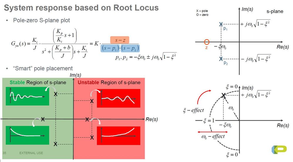

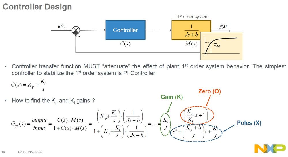

You will become familiar with the procedure for analyzing the control system stability based on poles and zeros location and then we will compute the PI speed controller gains using the Root Locus allocation method.
From now on you should have no issues to understand what a system pole or zero means and you should be able to take design decision based on the system transfer function.

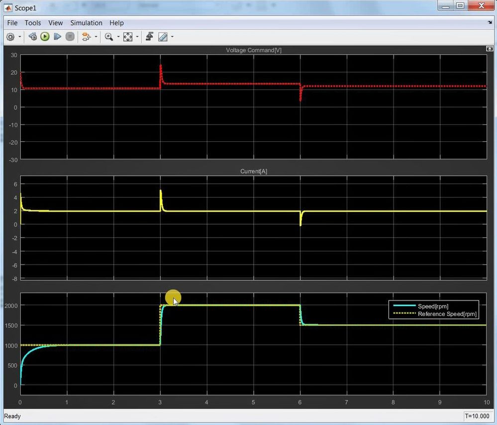

Also, we are going to verify the control system designing process by simulating a BLDC motor behavior and building a PI speed controller to handle the system response.

    - How to choose the controller type based on system transfer function;
    - How to analyze system stability starting from the characteristic polynomial;
    - What are the gain, zeros and poles of closed loop transfer function;
    - Root Locus allocation method based on second order ideal model with dumping factor and natural frequency;
