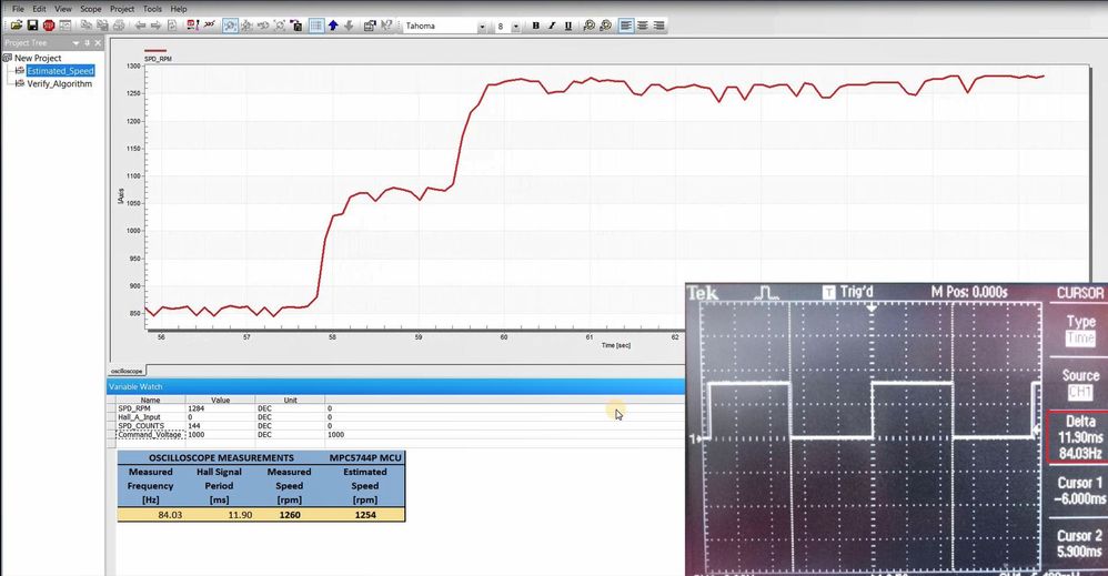

In this 10th lecture of the motor control course we discuss about to build, simulate and test a Speed Estimator based on hall sensors information related to rotor position. The speed estimator is first tested under Matlab Simulink environment where its functionality and precision can be easily tested for a multiple of input frequencies. Once its operation is validated in the simulated environment the estimator is ported into the Open Loop Control model and tested on the real HW platform MPC5744 Development Kit with the BLDC motor spinning at various levels. The estimator accuracy is compared against the real motor speed measured with an oscilloscope.

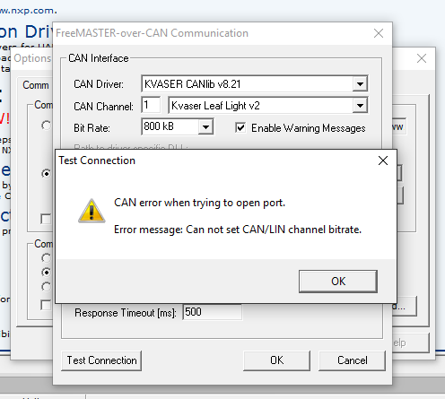

mahdkhalid
Thank you for the reply. I have soldered the resistor for termination and have tried different baud combinations. I get the errors, ''No data received'' and ''Can not set CAN/LIN channel bitrate.
38,010 Views
Daniel_Popa
Hi Mahd,

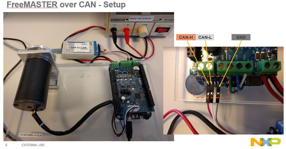

Since you have set the Simulink model to 500kB bit rate then the FreeMASTER should work with 1Mb assuming you are using the small development board as i did in the video.
The CAN interface looks like this:
Assuming the CAN HI/LO are connected correctly, have you powered the board with 12V by making the appropriate settings  on the board? https://www.nxp.com/docs/en/supporting-information/DEVKIT-MPC5744P-QSG.pdf
If everything is fine up to this point, then perhaps we should check if the boards transmits something over the CAN. You can load the CAN demo: can_model_pnt.mdl and check with a CAN sniffer if you receive anything over the CAN with your adapter.
Hope this helps!

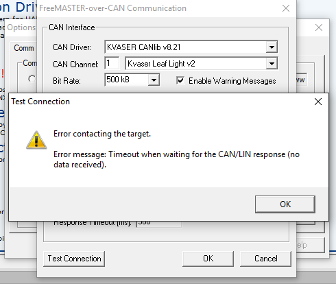

mahdkhalid
2/2
I have tried another thing. Without plugging in the controller and without loading any elf file I just plugged in my CAN adapter and tested connection on FreeMaster. It detects the CAN adapter and the driver but gives error ''Could not open the communication port''.
38,010 Views

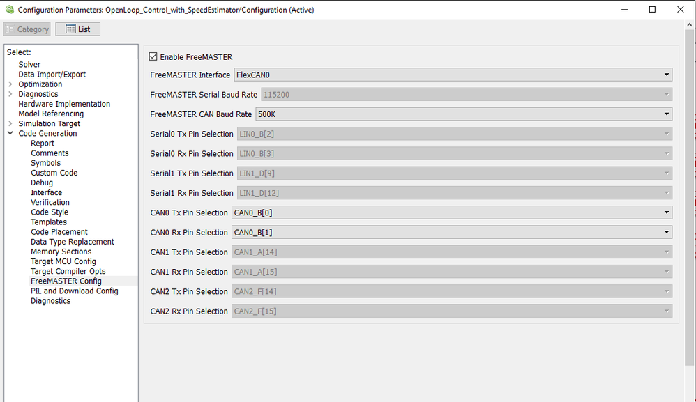

jjacp
Hi dumitru-daniel.popa,
I noticed in the MPC5744P config block, you set the FreeMASTER CAN bus speed is set to 500K, but in FreeMASTER, you have it set to 1M. I confirmed that this is the same on my setup (FreeMASTER can't connect if you set the speed to 500K). Also, if I set the config block to 1M, FreeMASTER doesn't connect even if set to 1M. Is this a bug with the model config block?
Thanks!
38,007 Views
Daniel_Popa

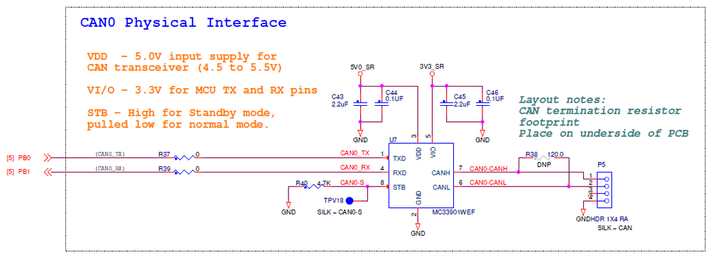

Good catch jjacp‌
There is an issue with the toolbox. The same same toolbox supports 2 type of MPC5744P development boards. Between these 2 boards the CAN tranceiver is different - and we found that after the toolbox release. The idea is that the same timings set for MCU cause different CAN baud rates on the boards. In particual for the small MPC5744P DevKit the baud rate is going to double. That is why the model has the 500K and the FreeMASTER is set to 1M.
We choose to let it that way, assuming that customers will create their own designs with the MCU and will handle correctly the CAN tranceiver circuits. In that case you should get the same CAN baud rate as the one set in the MCU.
The alternative would be to have the toolbox to support different board characteristics. This is something we are thinking about too.
