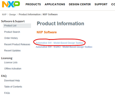

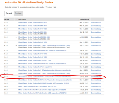

Hello @bobbylivewire
Please, download the MPC toolbox from NXP MBDT official website https://www.nxp.com/design/design-center/software/automotive-software-and-tools/model-based-design-t...
Press on Downloads button, and you will be redirected to the following page:
Here, go to Automotive SW - Model-Based Design Toolbox and choose the Model-Based Design Toolbox for MPC57xx Automotive Microprocessors Family
The latest version of the MPC57 toolbox is compatible with MATLAB R2024b.
Hope this helps!

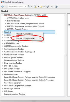

Thank you.  I have this installed, but the MPC57xx library doesn't show up in the Simulink library.  How do I add it to the library?
20,341 Views
stefancinipeanu
If you are not able to see the MPC57xx library, please right-click on Simulink library and press Refresh Library Browser. Then you should have the NXP Model-Based Design Toolbox for MPC57xx MCUs library.

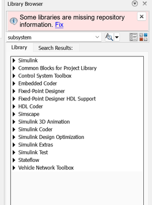

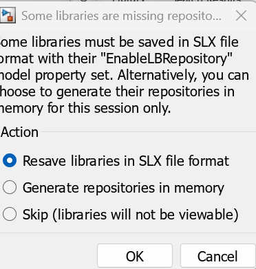

bobbylivewire
Hi Stephan,
I refreshed as you said, but still do not see it and get this error:
So I click fix, and get this:
Then click OK, but still do not see the library.
Any ideas?
