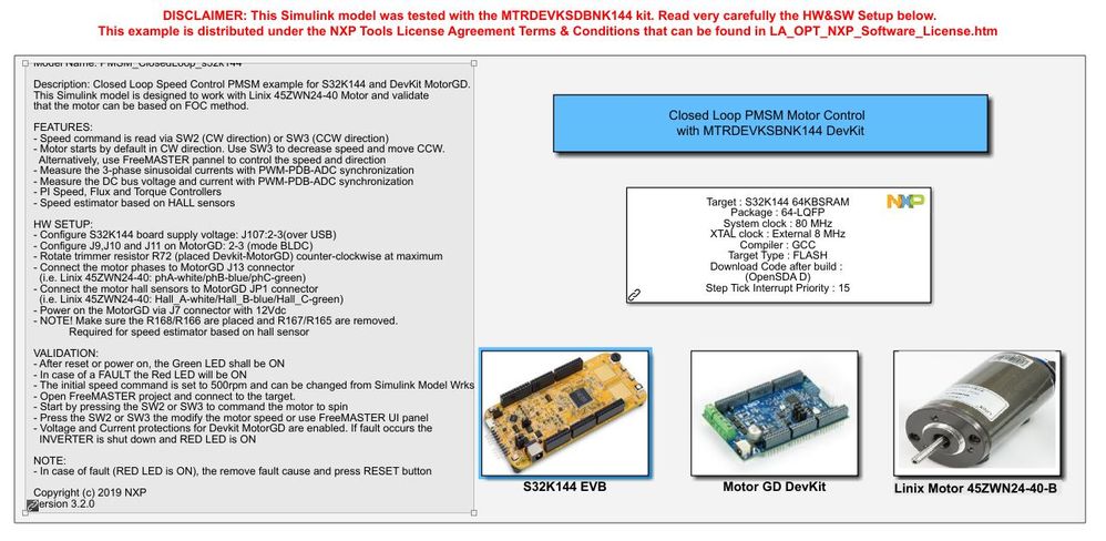

1、I didn't find example of pmsm scalar control using exactly your hardware. (FRDM-KV31, FRDM-MC-LVPMSM, Linix 45ZWN24-40)
2、For this Model based design example of S32K144EVB, I would like to know how to achieve MBD simulation only.
how to write to the "Electric Motor Model", I did not find the Motor Model in the example

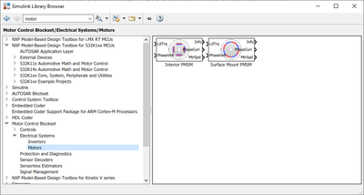

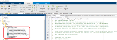

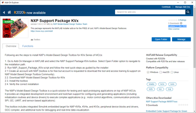

1. Install NXP Support Package KVx (Updated 21 Dec 2020) and open it. Then follow instructions to install NXP_MBDToolbox_KVx. Support package can be found in Matlab Add-On Manager, or on NXP MBDT web pages
The pmsm scalar control example will be then located in:
C:\...\MathWorks\MATLAB Add-Ons\Toolboxes\NXP_MBDToolbox_KVx\KVx_Examples\KV3x\applications\pmsm_scalar_control
2. Model based design example of S32K144EVB is example intended for real system (Final Product). It is not simulation. Creating simulation is up to you. Real example can be helpful. First you have to use simulink model of electric motor (Simulink Library Browser -> Motor Control Blockset -> Electrical systems -> Motors), then create the control algorithms etc.
