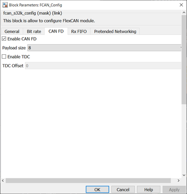

To use CAN FD you have to disable the Rx FIFO (if it isn't already disabled) in the Rx FIFO tabfrom FlexCAN Config block, and enable the CAN FD in the CAN FD tab, by selecting the Enable CAN FD option.
Once you do that, new options will we enabled in the CAN FD tab: selection of a different maximum payload size and configuration of TDC (Transceiver Delay Compensation).

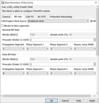

Also in the Bit rate tab you will be able to configure Data Bit Rate, used when the BRS (Bit Rate Switch) option is select in the FlexCAN send block. By default, Bitrate to time segments option is selected, which will compute automatically the value of the timing registers from a given Bitrate and Sampling Point. For CAN FD I recommend to uncheck it and set the values of the timing registers to the same values used in the CAN Analyzer/probe.

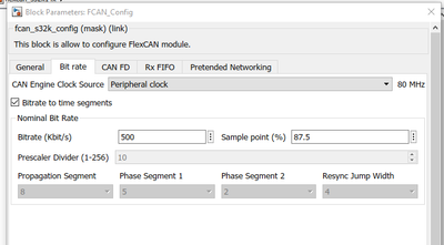

I'll post a picture of the configuration of the bitrate of the model that I am testing (which is basically the same that the example has), because I don't understand the issue, how it gets to build it without the patch but with the patch it can't find the bitrate?
As you can see I don't even have the CAN FD box active. This leads to the issue that it doesn't work with CAN FD activated either.
