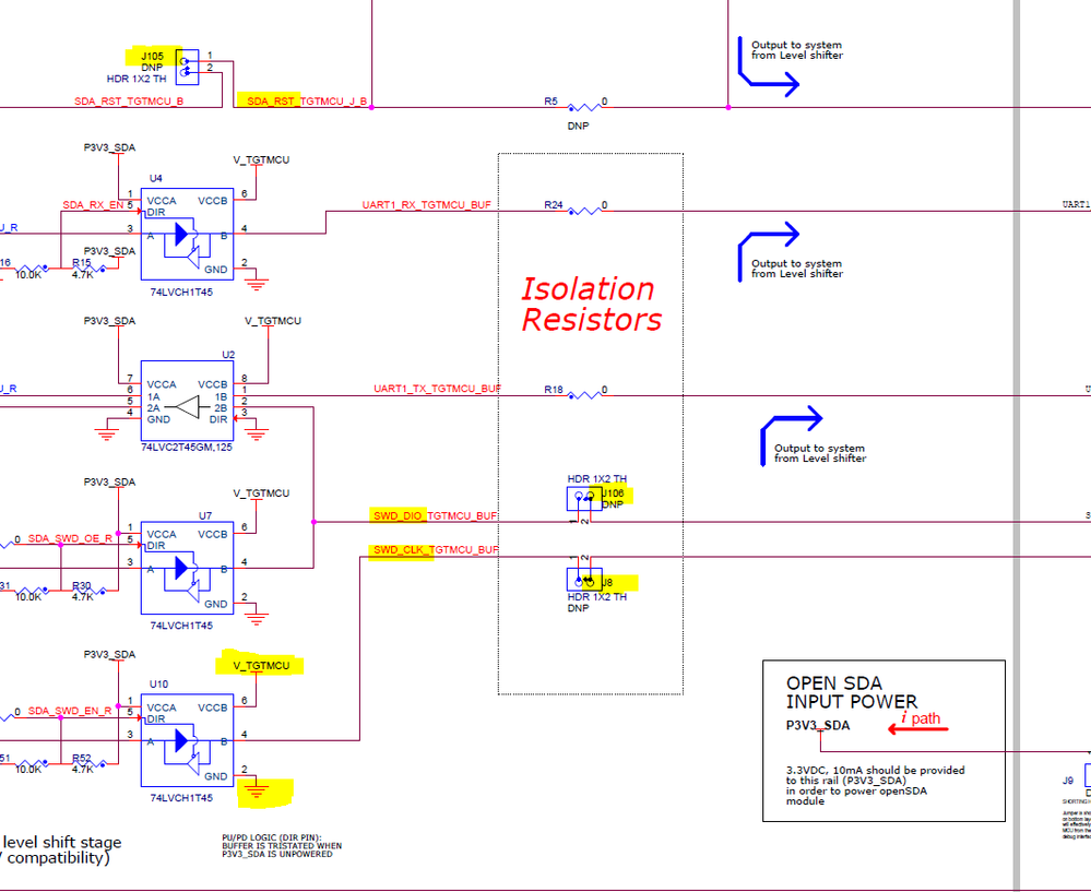

For what you tried, now having a more closely look on the EVB schematic, the pcb designers provided the J105(RST), J106(DIO), J8(CLK) jumpers, but not populated. By default (as you can see in the image below) they are connected, so instead of desoldering R122 and R127 you can just break their links and use the jumpers pin 1 to connect to the target. But where you connect the SWD wires does not affect the functionality.
However, what I am wondering right now, is whether you have connected or not the GND between the boards, this is very important. And also, you need to be sure that the V_TGTMCU has the same voltage with the one that the slave controller has, 5V. The thing is the OpenSDA works at 3V3 logic level while the S32K144 runs at 5V. The 74LVC2T45GM works as a level shifter so it should be powered both ends. Last to be checked is if the J104 on the EVB has the right connection (2-3) and if the RST pin triggers the slave controller you need to flashed.

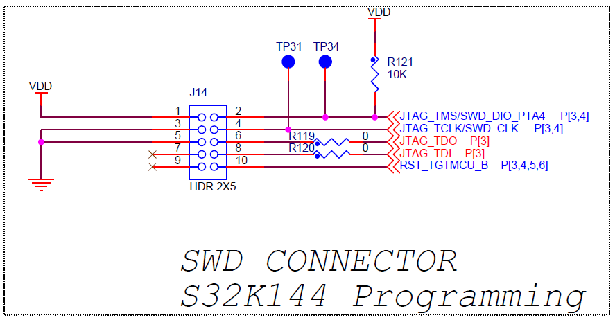

2. If you really want to use the OpenSDA from the EVAL Board, I think you need to consider connecting the pins from J14 (from the EVB schematics) to your custom PCB: RST/DIO/CLK pins. Don't forget about the GND!
But if you connect them directly, now you have two MCUs connected to the same openSDA so you need to break the DIO and CLK signals connection with the MCU from the EVB. You can do this by removing the 0R resistors R122 and R127 according to the S32K144EVB-Schematic, page 3.
