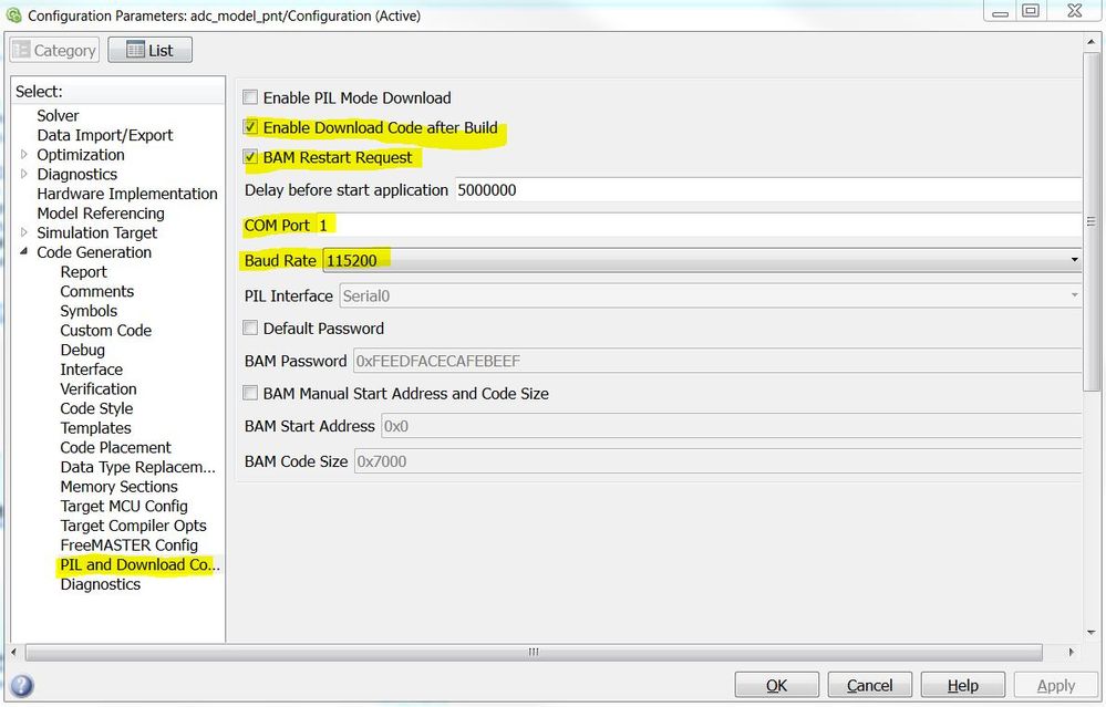

How did you configured the serial port from the MATLAB Toolbox. Can you attach a snapshot with Download settings panel from Configuration Block ?
It should be something like this:

dsytj88
Hi,Daniel
I checked the configuration which is as the same as yours.
even I try to use the tool in matlab tool box directly,the error is the same,please see picture as belows:
by the way,I didn't see abnormal case for driver or something else.

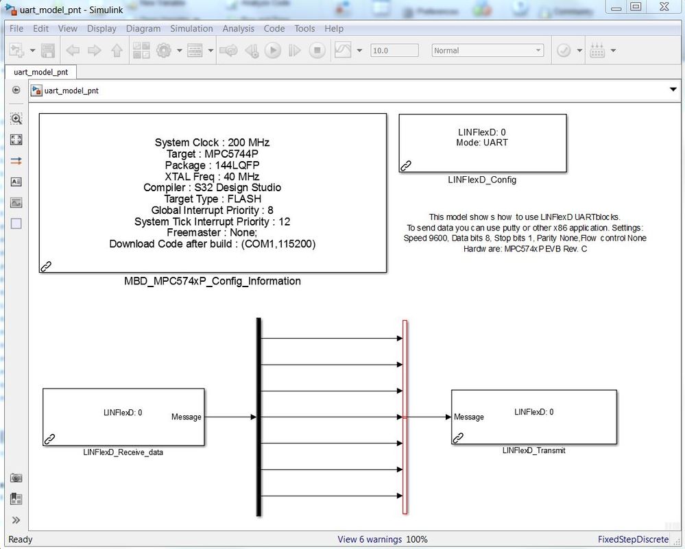

Daniel_Popa
OK - but how do we know that DTECH works ?
Have you been able to validate the Serial communication with the board yet ?
If something is wrong with that then the Matlab has no means to to connect with the board via UART.
Here is how i should test it:
#1: I would take the uart_model_pnt.mdl from the Toolbox example and build it. No download to target - just to get the elf.
#2: Using S32DS and JTAG i would flash this elf into the target (similar with what you have done with RBF file). Keep in mind that this will overwrite the RBF so later on you will need to reprogram it back.
#3: then reset the board and connect to the UART with any COM sniffer and try to sent a character
If you get that character back (if you are allow to sent a new one) then it meas the UART work.
#4: check with an oscilloscope that we get both RX TX signals when this happens.
To make the test more realistic i would modify this demo project to sent continuously from target to the Host PC a string of DATA just to make sure the UART is stable.
Hope this helps!

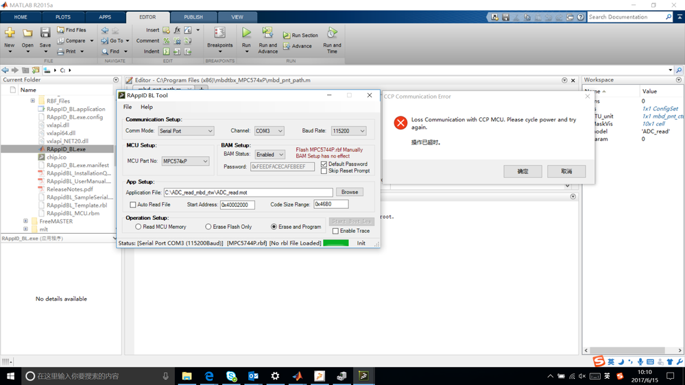

dsytj88
Hi,Daniel
I have attached this picture in this message.
the message box indicates to do some operation,but the problem is:
the message box can't restored,and I can't click Ok button.
Please see the messsage box in the file.

paulvlase
Hi [email protected]‌,
Can you check if there is any exception/error/warning in the Matlab Console window?
Try to select the dialog window from the Taskbar and hit 'Enter'. The default option is 'Yes' so it should proceed with the download of the application.
The requirement for downloading the application is to have MPC5744P.rbf (from C:\MBDToolboxtools\BootLoader\RBF_Files) flashed on the board. You can use the S32 Design Studio for Power Architecture to download this .rbf image.

Daniel_Popa
Hi David,
That message box tells you to restart the board in order to program the application into the MCU memory. Prior of that you need to program the RBF file into the MCU memory in order to do the handshake between Matlab and BAM algorithm (ADC programming video starting with minute 2.20)
Nonetheless, since you are saying that you can control the Message Box Window - i think this might have something to do with your Windows OS: i see that you are using Windows 10. Can you choose a different theme in your OS ?
One workaround would be download the application manually to the board using the RAppID_BL.exe application from {MBD Toolbox install folder}\mbdtbx_MPC574xP\tools\BootLoader
In this case you should disable the "Enable Download after build" and "BAM request delay" from Simulink model properties.
In the mean time - i will try to figure it out why the dialog box created from Matlab does not work on some Windows 10 OS.

dsytj88
Hi,Daniel
Since I use USB serial line for communication between development board and PC,the seperate programming by RAppID_BL.exe is failed,I see this tool is supported with XCP protocal,that means I need to use CAN bus for communication,but now I don't have this tool.
for the bootloader programming,it's fine.
In win10 operation system,I have to find out the reason why the message box can't be operated in my PC.even I try to change the theme in my laptop,it doesn't work,do you have any progress?

paulvlase
The MBD Toolbox is running RAppID_BL.exe to download the built application to the board, but you can download the generated .mot file manually. It supports both UART and CAN communications. You find it in C:\MBDToolbox\MPC574xP\tools\BootLoader.
I don't understand what problems you had with it. You have to select from 'Comm Mode' dropdown 'Serial Port'.
In my case the serial port (over USB converter) is COM31.
Set 'MCU Part No:' to 'MPC574xP', 'BAM Status' to 'Enabled', and check 'Default Password'.
Select the generated .mot file and press the 'Start Boot Loader' button.
