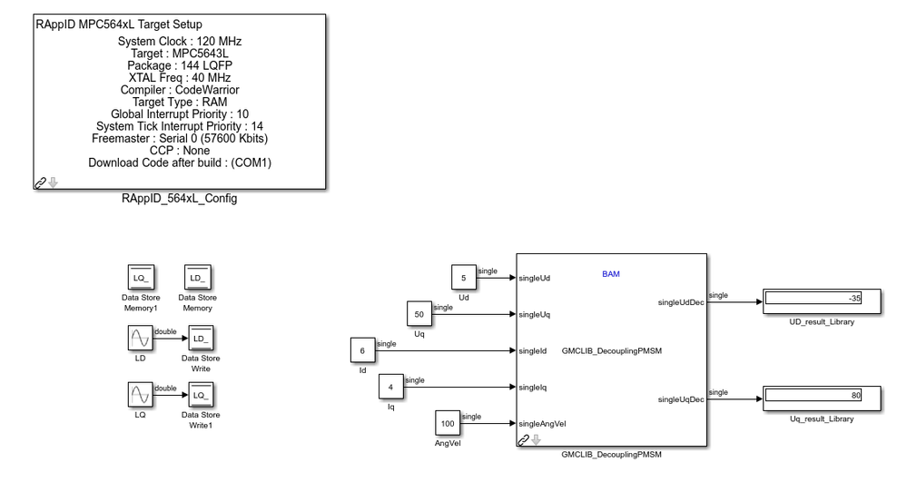

Hi Guys,
Recently,i come across a question, that is,the parameter of Lq and Ld  dynamically change ,so,i wanna realize the LD and LQ dynamically change when the program running.But i can not solve the question when use the Block of GMCLIB_DecouplingPMSM.
The attachment is my Model.
the picture shows it.
Original Attachment has been moved to: Decoupling.slx.zip

Daniel_Popa
Hi edenli‌,
I'm afraid you can't do what you want with this NXP library block. Similar with some of the Simulink blocks if the block was not designed from the beginning to allow such changes then it simply can't be modified to accept such inputs.
In this case - the only way to tackle the problem is to implement a similar functionality with standard Simulink blocks that allows on-the-fly parameters changes.
By the way, may i ask why do you need such functionality - what is your project about to ?

paulvlase
Hi edenli‌,
I created the GMCLIB_DecouplingPMSM_Custom block with those two parameters from GMCLIB_DecouplingPMSM changed to input ports.
Please download the MCLIB for MPC564xL.zip, unzip it over C:\MCToolbox\rappid564xl\MCLIB for MPC564xL or replace this folder with the one from the archive.
I am waiting for your feedback,
Paul

edenli
Contributor V
Hi Paul Vlase and daniel,
First,I am sorry so late for reply .
Thank you very much for reply!Now,i test your block about the GMCLIB_DecouplingPMSM_Custom,the result is very good.
Best Regards!
Eden Li.
