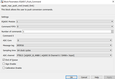

Alternative Solution for Resolver Feedback:
The resolver COS and SIN feedback is normally evaluated through SDADC, as stated in the application note:
  • Sine     --> SDADC 1:  M_ANA0_SDA0 ANA0 /SDA0
  • Cosine --> SDADC 4 M_ANB0_SDD0  ANB0  /SDD0
Since SDACD is not available, EQADC might be used instead. I would configure the EQADC as follows (example for COS evaluation on channel ANB0):
Question for support:
  • In general: is this possible?
  • Can you confirm the followin: With this approach I "loose" two EQADC channels, which are normally needed to read the current and voltage measurements. I understood, that this board does only have a max. of 4 EQADC channels.

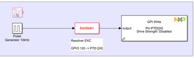

Alternative Solution for Resolver Excitation:
Resolver excitation is done using ETPUA6 /GPIO120. To bypass the eTPU I intend to write a 10kHz square wave signal directly to the GPIO120 pin (PTD24):
  • Is this approach feasible?
  • If not, what else can I use?
