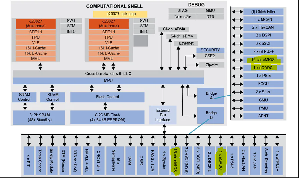

I am using mbdt package to work with MPC5777C-DEVB board. When working with ADC module i get this message on the ADC blocks "The selected MCU has no support in MBDT for this peripheral". The same info is given on the help page of the block.
I found similarly most of the motor control blocks in motor control blocks such as CTU, FlexPWM, eTimer blocks are also not supported.
Is there any new version of mbdt where these blocks are made avaialble?
3,510 Views
mariuslucianand
Hello @abhinand_rd ,
The peripherals that you are mentioning are not supported on the MPC5777C because this controller does not have such hardware. To generate PWM, you can use the eMIOS modules, and for ADC the eQADC modules which are supported in our toolbox.
You can see here the peripherals that the MPC5777C has.
Hope this helps,
Marius
