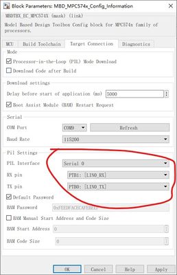

I recently brought MPC5748G REV board.
I am using MATLAB 2018b
I tried to run the example in MPC _Example -> common-.> Pil
code gets generated, compiled, flashing starts with erasing and completes 100%.
Then error comes and stops.
Error: "The Timeout of 10 seconds for receiving...."
I am sure is the problem that the wrong set of the PIL interface!
How to set the PIL interface? (as shown in the following figure)
Thanks in advance

I got it!
答案如下图所示,哈哈,完美运行 
