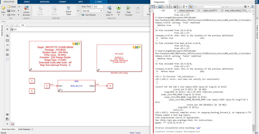

Hi, i have a MPC5775E-EVB .I can't use MBLIB within SPI defined project.When i just put spi configure block on this simple project, i got the error.
what causing this problem?
My Matlab version:2020a .I also made "set path" configuration for AMMCLib.
MPC5775E parameters
Compile Options: -g3 -mbig -mvle -O1 -mregnames -mlsp -specs=ewl_c9x.specs -mhard-float -Wall -c -std=c99 -fdata-sections -ffunction-sections -funsigned-char -fmessage-length=0 -nostdinc -fno-jump-tables -DTURN_ON_CPU0
Assemble Options: -g3 -mbig -mvle -mregnames -O1 -DTURN_ON_CPU0 -mhard-float
Link Options: -Xlinker -gc-sections
regards.
v15.c: In function 'v15_initialize':
v15.c:145:1: error: insn does not satisfy its constraints:
(insn/f 117 116 118 2 (set (mem/c:V2SI (plus:SI (reg:SI 11 %r11)
(const_int 0 [0])) [0 S8 A8])
(reg:V2SI 31 %r31)) v15.c:54 2475 {*movv2si_internal}
(expr_list:REG_DEAD (reg:SI 11 %r11)
(expr_list:REG_DEAD (reg:V2SI 31 %r31)
(expr_list:REG_FRAME_RELATED_EXPR (set (mem/c:V2SI (plus:SI (reg/f:SI 1 %r1)
(const_int 360 [0x168])) [0 S8 A8])
(reg:V2SI 31 %r31))
(nil)))))
v15.c:145:1: internal compiler error: in copyprop_hardreg_forward_1, at regcprop.c:775
Please submit a full bug report,
with preprocessed source if appropriate.
See <http://gcc.gnu.org/bugs.html> for instructions.
gmake: *** [v15.o] Error 1
Error(s) encountered while building "v15"
UPDATE

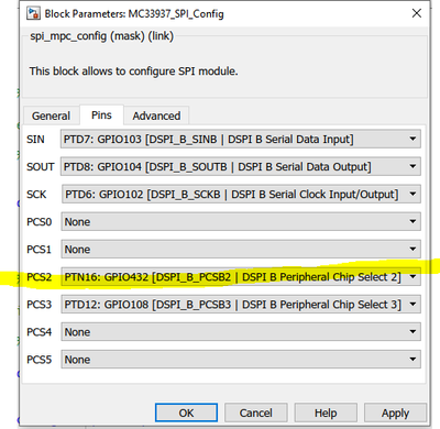

If i disable CS pin from SPI Config block , Automotive Math and Motor Control library error is dissapear. But i need to CS pin.
4,907 Views
mariuslucianand
Hello @engineer_attila,
It looks to be something related to the compiler. The workaround I've found is to assign another CS pin in the SPI block. It can be a pin that is not used in your project.
Can you please try this workaround?
Marius

mariuslucianand
Marius
4,893 Views
engineer_attila
That works, thank you @mariuslucianand.
