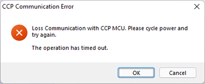

I'm getting started with Matlab/Simulnk MBDT examples with the following configuration:
MPC5748G Rev D Dev Kit
Model-Based Design Toolbox for MPC57xx Series Version 3.2.0
Matlab/SImulink R2020a

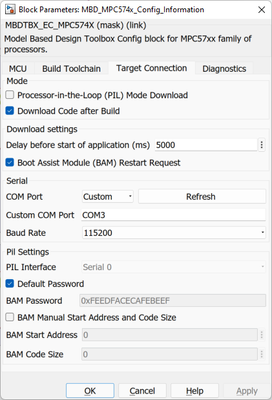

I have built the UART Hello World example but am getting a 'Loss Communication with CCP MCU' error when flashing.

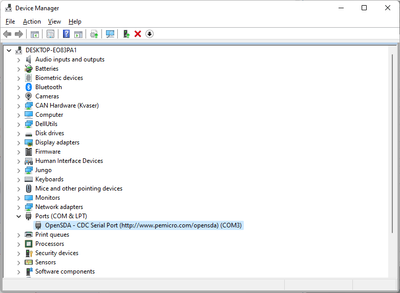

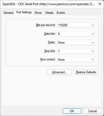

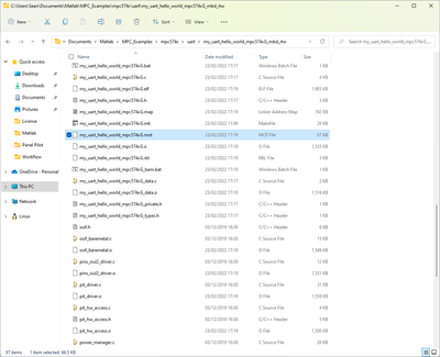

I have confirmed the serial port settings in device manager and tried taking the *.mot file from the ***_rtw folder and programing it with the RAppID_BL.exe

Found the issue in the end - computer was too slow.
Time between pressing reset on dev board and it re-starting was too quick for RAppID to popup and detect the Boot Loader.
