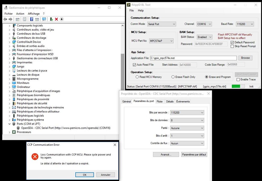

abhishek_kumar1
Dear Fabien
  1. Please select the right COM Port in Config Information and check with Device Information (OpenSDA)
  2. For Device Information (Control Panel ->Devices and Printers -> OpenSDA Hardware (right click) -> Properties > Hardware Tab > Select Open SDA and see properties ->Port Settings Tab)
  3. See that both totally match (Simulink and Device Settings)
Best Regards
Abhishek

fabien_claveau
Hello Marius,
I tried your RBL setting file, and used your .mot generated with Matlab 2017a (that I copy-paste also at the root of C:/).
Still the same problem; you can see below the configuration of my COM port (according also to the message of Kumar), RappID BL, and the error message.
I tried with my "original" rbf file, but also the other one you mentioned before.
I tried with or without the 12V power supply...
Let's assume that the Boot Loader procedure do not work with my board...
If I flash (or by using the debug tools) the .mot directly on the board with S32 DS (v2.1), should it work ?
                                           Fabien

fabien_claveau
Hi everyone,
I received recently a MPC5744p DevKit, Rev E1, that I try to program thanks to MBD toolbox in Simulink, without success...
My configuration is the following :
- Matlab R2017a
- MDB Toolbox 3.0.0
- S32 DS power architecture 2.1
- MPC5744p DevKit, Rev E1
- RBF file : MPC5744p.rbf file proposed by Marius on this page (thanks !)
I can flash the MPC5744p board from S32 DS software with some example already available (e.g. on the picture below the ADP_MPC5744p example is running) ; so I assume that the serial configuration is ok (COM16, 115200 baud ect...). In this case I don't use the MPC5744p.rbf on the devkit, but I directly flash the .elf or .mot file in it.
I can also compile codes with Simulink (I try several examples) ; I can see the generated .elf or .mot files in the folder ..._mbd_rtw.
But When I try to flash these files directly from Simulink (with the MPC5744p.rbf file flashed previously on the devkit), or by using the GUI of RAppID_BL, or by using the S32 DS interface, I always have the "Loss Communication with CCP MCU. Please cycle power and try again".
I can see the UART packets from the PC to the MCU with an oscilloscope (through the TP25 test points), and as expected to response from the board (no response on the TP24 test point...).
I tried with or without the 12 V power supply.
I think my jumper configuration (see below) is ok?
Could you help to solve the problem? Am I forgetting a simple trick... ?
Thanks !
Fabien
37,012 Views

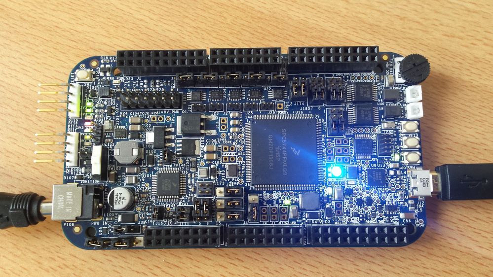

mariuslucianand
Hello [email protected]‌,
I have the same jumpers configuration on my RevE board as you, except the J31 which is not connected at all on my board, but I assume is something related with the power.  and also SW102 on the 1-2 position, but still, not related with the MCU.
Anyway, so you have a working .mot file, but you can not flash it using the RappID Bootloader. Just to be sure: do you press the RESET button just before you press OK in the dialog box appear just before programming? I am asking this, because the Bootloader is active just a couple of seconds after reset.
If there is no dialog bog that requires you to restart the board just check the Boot Assist Module Restart Request like in the following screenshot.
Hope this helps,
Marius

mariuslucianand
We used an MPC5744P EVB B and apparently the UART pins connected to the OpenSDA were changed. The current Bootloader works on pins PD9/PD12 while on rev E the OpenSDA uses the Serial configured on PB2/PB3. With the current bootloader you can use an USBtoSerial to program the board over PB2/PB3 pins?
Also, I've attached a .rbf file that uses (as far as I know) the PB2 and PB3 pins.
Hope this helps,
Marius

aungkm
Hi Marius,
The .rbf file which you have attached worked.
Thanks a lot!
