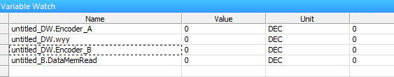

Dear Daniel
Thank you for your reply,I'm using 'Model Based Design ToolBox for MPC574xP', I want to read the register(CNTR) of etimer0,the address is 0xFBC2000C,and I add 'DataMemRead' module to read the CNTR value,then I debug in  freemaster,but the code can not run.
this is running status,all variable can not change,my simulink module will sent you by e-mail of [email protected].please help me!
Yuyuan Wang.

Hi Yuyuan,
Have you applied all the patches for MPC5744P toolbox ? The patches can be found here: HotFix: MBD Toolbox rev2.0.0 for MPC5744P (Panther)
I think your problem is related with patch number #3 https://community.nxp.com/thread/451804#comment-916493
If you use the S32 Design Studio for PA 1.2 or S32 Design Studio for PA 2017.R1 GCC compilers then you need to apply this patch or otherwise the program will not exit the startup sequence.
