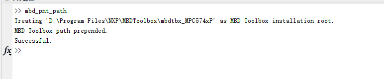

I am trying to use Toolbox for my project. After running  mbd_pnt_path, the result is successful. as the capture:

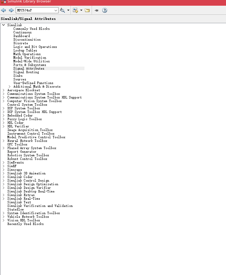

But I can not find the blockset in simulink bowser:

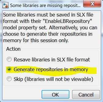

Hi Owen,
Please open the Simulink Library Browser and click on F5 to refresh the list.
Usually the Simulink should display this message and should allow you to fix the problem:
Then you should select: Generate Repositories in memory
Hope this helps!
