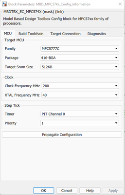

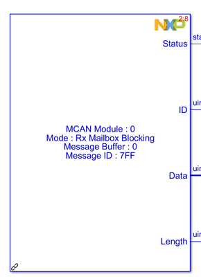

I want to use MCAN_Receive block in "Blocking" mode on the RDVCU5775EVM development board, but I get the error in the picture.
Can you help with this?

Hello @mariuslucianand
I have reviewed the page before and asked this question because I did not get any results.
5,204件の閲覧回数
mariuslucianand
Hello @peaces ,
Can you please have a look at this page?
https://community.nxp.com/t5/Model-Based-Design-Toolbox-MBDT/Build-Fails-When-Target-MCU-gt-Family-i...
Hope this helps,
Marius

HI @mariuslucianand
When we use the MCAN receive block, we encounter the error in the picture.
''''''Error: Simulink Coder Error: The specified port index 'Number' of <S2>/MCAN_Receive should be a number between 0 and 3.'''''
We applied the fields on this page
