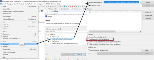

Make sure that when you import the project into MCU IDE you do not check the Copy project into workspace. This option will break the paths created in Simulink.
This is the flow I use in MCU IDE. I go to File-> Import -> Existing projects into workspace, Select Config project and make sure the Copy project into workspace is unchecked.

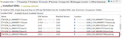

I recommend to recreate the <model_name>Config project - to do that go to the location of the mdl and delete the <model_name>Config project and also the _rtw project and do again a build of the model. Use again the export option for Hardware Settings in Simulink and export the project. Then import it again in MCU IDE. Make sure that you have the SDK for KV5 installed in MCU IDE:

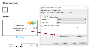

About this question:  "How to link the .mex file with the Simulink file?" - The .mex file is linked to the simulink model by its name. The .mex file naming convention is <model_name>Config.mex (similar for the project created with the SDK files that are needed to build the final application from Simulink). In order to modify the parameters of a block (or configure extra pins, change clock settings), just open a block from the model and press the Configure button:
This will open the <model_name>Config.mex file using MCUX Configuration Tool (this tool is incorporated into the toolbox). After this you can modify the .mex content - after you did the desired modification just save the file (ctrl+S) - there is no need to use the Update Code option from MCUX Configuration Tool. Going back to Simulink, just press the Update button found inside the block. This will tell the toolbox that the mex file was changed and to consider the changes in the code generation and build process.

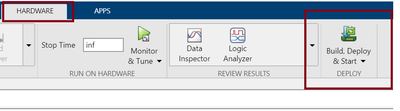

When you press the Build and Deploy button in your model:
Besides generating code for the blocks you have in the model, the toolbox will also generate the C and header files for your <model_name>Config.mex file. These files will be located in <model_name>Config folder, in board subfolder: peripherals.c, peripherals.h, pin_mux.c, pin_mux.h, clock_config.c, clock_config.h) - that's why you don't need to Update Code from Configuration Tool. At Build&Deploy&Start step the <model_name>.axf file of the Simulink model is created and it tries to downloaded on the board based on the settings your model has in Hardware Implementation -> Target hardware resources -> Download.

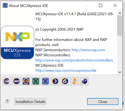

I have MCUXpresso IDE v11.4.1: (latest available on the NXP site).

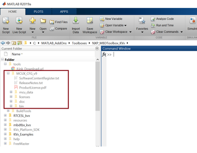

I have the NXP KVx 1.0.0 toolbox (this is the only release so far). and I use the configuration tool that comes with the toolbox:

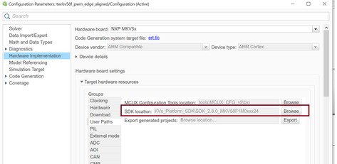

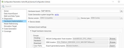

This is the version that is used by the toolbox when the C files for the .mex file are being generated. And also this is the version that is opened when the user is pressing the Configure button from the NXP block. You can see the tools that the toolbox is using in Model Configuration Parameters:
The SDK path is used to create the content of the <modelName>Config folder - all the driver files, startup, additional component files are taken from the SDK package.

I'm using MCUXpresso IDE v11.4.1; Did you try to import, build and run an SDK example? You need to go and download the SDK from NXP MCUXpresso SDK: https://mcuxpresso.nxp.com/en/select look for below processor:
Let me know if you need help on installing the SDK in mcuxpresso IDE.

Did you change the SDK path of the model? That's the only reason I'm thinking is causing that version to be put in .cproject: In Model Parameters Settings -> Hardware Board -> Target Hardware Resources:
