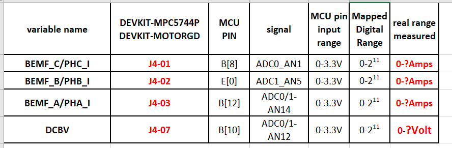

liwuquan
NXP Expert,
Thanks for the help so far.
Please help on my new questions below since the documentation needed is not available on NXP website.
It is regarding DEVKIT-MOTORGD and DEVKIT-MPC5744 pair for motor control, the table attached here is about the current and DC bus voltage measurement on the pair, my questions are:
1: please let me how much the number in the last column in the table suppose to be?
2: how BEMF and PH current measurement is sharing the ADC channel? through jumpers? then which jumpers, how the configure should be?
3: if you see there is anything not correct in the table regarding the pair of the board, please let me know.
4:please provide schematics for your MOTORGD, if you do not have the updated version, the old version is fine to me.
Thank you.
