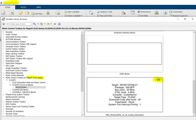

Would you please show me (take a screenshot and post it here) the MBDToolboox for S12ZVM in your Matlab2020a/Simulink browser ?
Almin
40,084 次查看
constantinrazva
Hello @almin_svraka ,
As you can see in the image below, on whatever setup I ran the installer on, I got it visible in the Simulink library browser.
