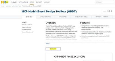

Hello @almin_svraka ,
Can you try do the following and see if this works on your end?
1) Go to https://www.nxp.com/design/automotive-software-and-tools/nxp-model-based-design-toolbox-mbdt:MBDT link
2) Click on Download button (at this step you will be prompted to log into your nxp.com account)
3) After you logged in, select the following from the list: Model-Based Design Toolbox for S12ZVMx Automotive Microprocessors Family
4) Click on “I Agree”
5) download the MBDToolbox_S12ZVMx_1.4.0_20200909.mltbx file
6) The file will be automatically saved as .zip – just rename the file to .mltbx [from MBDToolbox_S12ZVMx_1.4.0_20200909.zip to MBDToolbox_S12ZVMx_1.4.0_20200909.mltbx]
7) Open MATLAB – run the MBDToolbox_S12ZVMx_1.4.0_20200909.mltbx file
After you finish the installation process from MATLAB, you should be able to see the ZVM toolbox installed.
There is a big difference between the older ZVC toolbox and the updated ZVM one when it comes to installation - we switched to this mltbx as it is a Mathworks installation technology and we try to achieve a deeper integration within MATLAB/Simulink.
