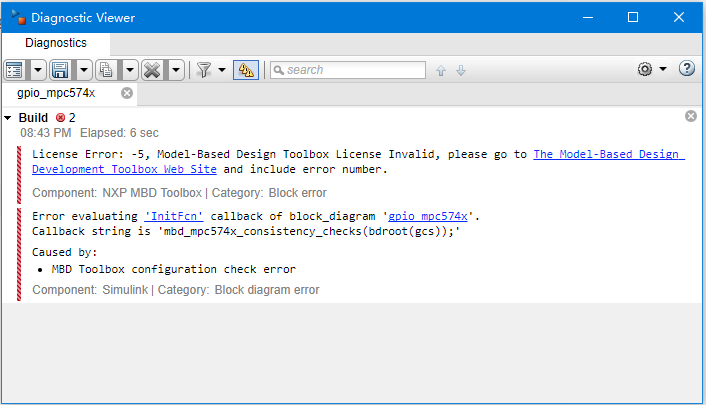

Hi everyone,
      Today,I install the MBDT for mpc574x. According to the indicate, I generate the lic file.Then I open the gpio_mpc574x.mdl,click the build button,the error appearance.Can you help me solve the problem?

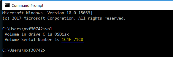

constantinrazva
Hello hongjinzeng‌,
Can you open a command prompt on your computer and run the following command
vol
and tell us if the Volume Serial Number matches the one from the license file?
(this is from license.dat file)
Kind regards,
Razvan.

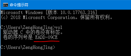

hongjinzeng
sorry, the Volume Serial Number is different.

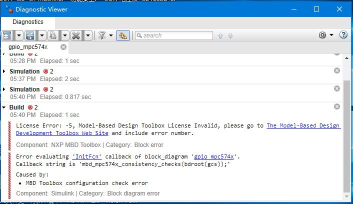

hongjinzeng
I try to generate the license again,but the issuse also remain.

hongjinzeng
The Volume Serial Number is same ,but also the error will appearance.
