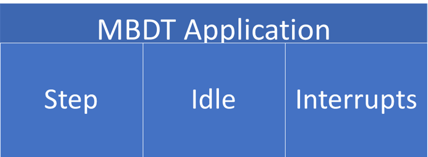

Lets look at how an application generated by our toolbox looks like (main parts in regards with execution time):
We have the following:
  • Step – a function called periodically, with a frequency controlled by the Discrete Step value set in the model
  • Interrupts – asynchronous events that can be further grouped into 2 categories:
    • Events that occur at a known period – e.g. a LPIT block that is used to trigger the Fast loop system for motor control applications – the important part is that you control the frequency at which this event occurs
    • Events that have an unknown period – e.g. receiving a message via UART/SPI/I2C/etc. – this is something that you have no control over, it can happen any time
  • Initialization – this is an important part of the application, but for CPU load it is of no importance
  • IDLE – this is the time period in which the Step function finished execution and awaits to be re-triggered and you have no ISR to execute (no such events were generated)
