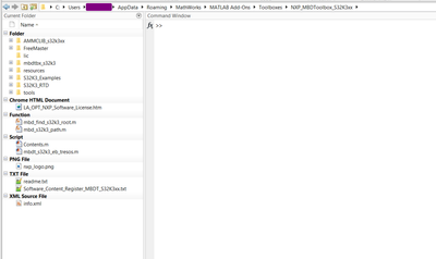

I have succesfully installed the 1.2.0 version of the MBDT for S32K3xx microcontrollers + the hardware support packages from the matlab add-ons.
I have access to the library in Simulink, but the hardware board from NXP (NXP S32K3) is missing in the list (attached image).
What can I do to resolve this issue?
Many thanks.

Hi, @jpb_cid ,
Thank you for using our MBDT S32K3 Toolbox. A quick solution to your problem is to close all the Simulink models, then remove the toolbox from the path by running in Matlab command line the following script mbd_s32k3_path('remove'). To re-add the toolbox to the path use the following command mbd_s32k3_path. To run this script, you have to be in the Toolbox root folder, as in the screenshot below. You could also try restarting the Matlab after this.
Let me know if any of these suggestions helped you.
Dragos

Hi @dragostoma,
Thank you for coming up with the solution. It was just that we were missing the "Embedded Coder Support Package for ARM Cortex-M Processors" from Mathworks, which was required when executing the mbd_s32k3_path command.
Many thanks and best regards,
Jon.
