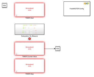

esantana
Hi @stefancinipeanu
Yes, I'm using MIMXRT1170 EVK but when I open your model I see some blocks like in the following picture:

stefancinipeanu
Hi, @esantana
The model presented in that post was made for IMXRT1010 EVK. I apologize for the misunderstanding. I have remade the model for IMXRT1170 EVK and I will attach it to this post.
Let me know if the error persists. Also, which version of the toolbox and MATLAB are you using?

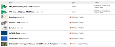

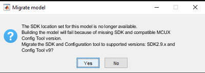

esantana
Hello @stefancinipeanu
Don't worry, thanks a lot for attaching the new design.
However, when I open it I see it as in the previous post. It appears this message when I open the design.
The Matlab version I'm using is R2020b and you can see the installed toolbox in the following picture:

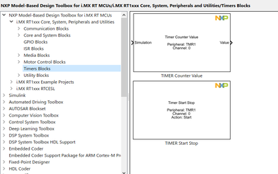

stefancinipeanu
Ok, so I see that you`re using the version 1.2.0 of the toolbox. We suggest to install the latest version of the IMXRT MBD toolbox because with the latest version(v 1.3.0) we have enhanced the toolbox functionalities and capabilities and we have also refactored many of the peripherals and features supported, including timer blocks. We`ve also delivered a newer SDK and MCUXpresso ConfigTools (version 2.11)
For example, in this case of profiling using timers, in the version 1.2.0 we did not have the Timer StartStop block for letting the user to control a selected timer starting and/or stopping the counting. All the starting, stopping and getting the current count value of a timer were included in the same block, being difficult for users to use it. In the latest version, we have separated these functionalities in 2 blocks. One block for controlling the timer and one for getting the current value of the timer, as depicted below:
 That is also the main reason why those errors of "Unresolved Link" appear in your model. Because Simulink cannot find those timers blocks that do not exist in the version 1.2.0 of the toolbox. Try to install the latest version of the toolbox and open again the profiling model that I have sent to you.

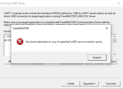

esantana
Hi @stefancinipeanu ,
I changed the installation path of the toolbox and now your example works correctly. However, I can't monitorize the ticks using freeMASTER because I can't connect the board with freeMASTER app. I attached the error window when I try to connect using the connection wizard.
