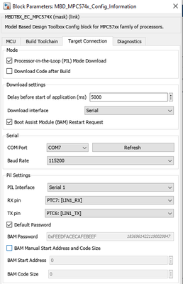

I have encountered some issues trying to run PIL on Simulink.
Here's my setting for running the software:
I have followed the video from NXP but I kept getting this error:
Error:The timeout of 10 seconds for receiving data from the rtiostream interface has been exceeded. There might be multiple reasons for this communications failure.

Here's my setting:

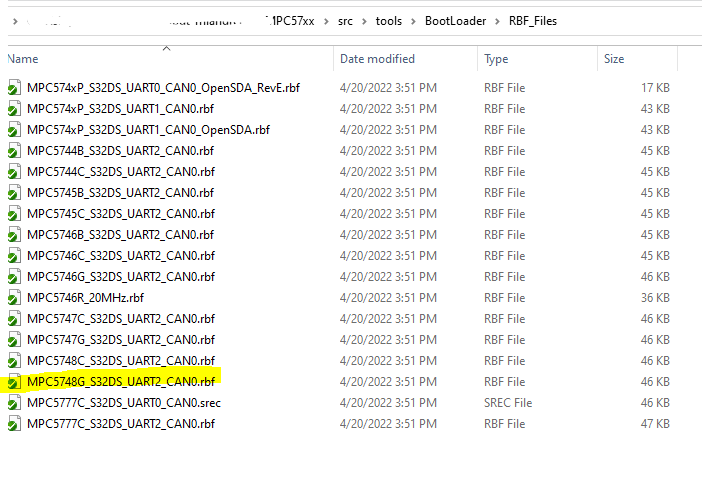

1. RAppid Bootloader - When selecting the Serial communication deployment inside the main config block, the deployment will be performed via serial communication but a bootloader needs to be executed on the board. So in this case, you have to first flash the Rappid Bootloader suitable for your board, so that when the PIL execution tries to flash the MCU, this one needs to know how to accept the binary file.
These files are located inside the MBDT tools files  under tools/BootLoader/RBF_Files
Please find more details here: https://community.nxp.com/t5/Model-Based-Design-Toolbox-MBDT/Rappid-boot-loader-for-MPC5744P/m-p/655...
This process is also described in the Release Notes, under BootLoader Setup, chapter 2.3
2. Communication pins - once you have checked step one, please check on the schematics of the board revision you have, that the serial pins connected to the OpenSDA are the ones selected inside the configuration of the main config block.

I have loaded the bootloader from S32 Design Studio and able to download generated code from Simulink to the MPC5748G board. However, when I tried running PIL following instruction on the same board, error occurred. As for the pins, I've looked at the schematic diagram and tried serial 0 and serial 1, but neither of those worked.
