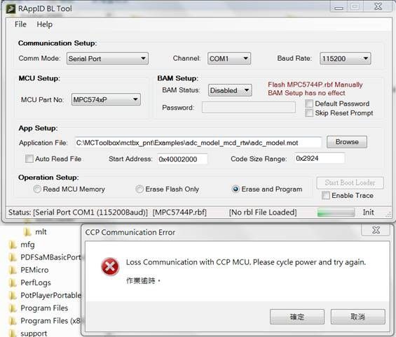

Hello Sir,
We found an error message when using the Rappid bootloader for MPC5744P.
Dose that mean the Rappid bootloader doesn't support MPC5744P?
Could you help?
Thanks a lot.

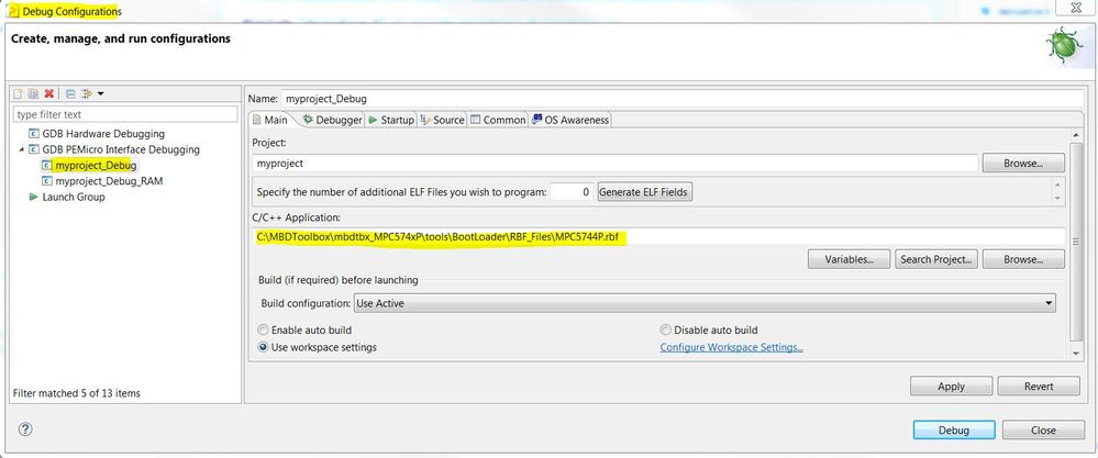

It is relatively simple. First you need to create a New S32DS Project for the MCP5744P.
Then, once the project is created, you will use a trick:
1: go to Debug Configuration
2: select the Flash launch configuration
3. change the project elf to the rbf file you wish to program on flash
4. click on Debug and that will flash the rbf into the MPC
Hope this helps!

raduivan
Hi Kent,
   The MPC5744P is supported by the RAppid bootloader. Before using this tool you need to write MPC5744P.rbf  to the target (see ${InstallDir}\mctbx_pnt\tools\BootLoader\RBF_Files\MPC5744P.rbf). You can use "S32 Design Studio for Power Architecture" to perform the flash write. After you need to reset the board and try to use the bootloader directly.
Radu

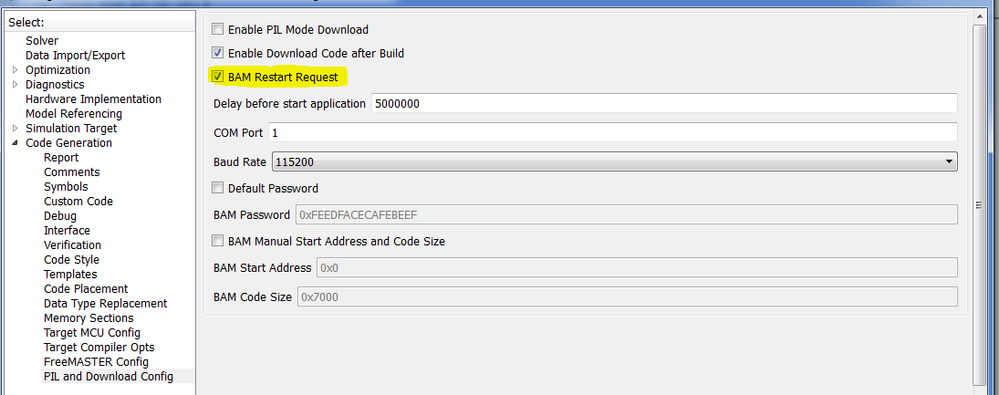

raduivan
Hi Kent,
   You have to define the appKey and other symbols, please see below an example but you can also generate the code as reference, BAM option enable, using the Toolbox and look how the BAM is used. For more details please see "RAppidBL_UserManual.pdf".
C
#pragma section R ".appDelay" ".uappDelay" data_mode=far_abs
__declspec(section ".appDelay") const uint32_t appDelay = 5000000;
#pragma section R ".appKey" ".uappKey" data_mode=far_abs
__declspec(section ".appKey") const uint32_t appKey = 0x55AA55AA;

kentlin
Hi Radu,
After programming the rbf file to MCU, then reset the MCU ,it can't communicate with Rappid bootloader GUI.
But it can work without manual reset. which is not the same as you mentioned.
There is the other quesion. The application code can not work normally after the Rappid bootloader programs the MCU successfully.
Does the application code need to be allocated in a specific flash address?
