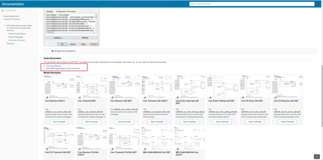

MBDT integrates the RTD (Real-Time Drivers) for configuration and access to the hardware (peripherals, pins, clocks, interrupts). For more details on configuration parameters, and functions implemented by our blocks, you could check the RTD User Manual for the component you would like to use, and also the AUTOSAR driver standard (RTD MCAL layer is AUTOSAR compatible).
For CAN, and other blocks as well, you could access this documentation I am referring to by clicking on the Help button of the Simulink block, and navigating to the Code Generation section, like illustrated below.
For configuration examples, you could check the configuration projects that we are delivering together with our application examples.
Moreover, in case of the ADC, PWM, CAN, UART and DIO, we have also put together some articles on our MBDT NXP Community, that provide a more detailed insight into the available parameters, and settings. Maybe you would find them useful as well. Here is the link to the CAN one, but the others are available under the Beginner's Guide for Model-Based Design Toolbox section on our main page.
