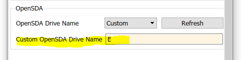

Hello @orange_ ,
If you press the refresh button, the driver E should be displayed next to the Custom option, like in the following image. But make sure you have the OpenSDA selected because it looks like the model tries to download over the Serial option.
If this still does not work, select Custom option but type only the letter E in the Drive Name.
Hope this helps,
Marius

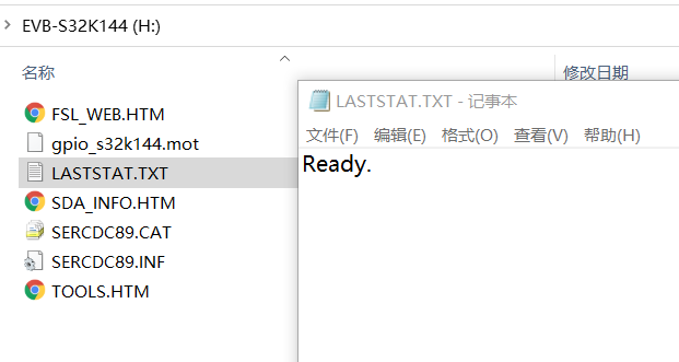

mariuslucianand
Hello @orange_ ,
It looks like the .mot file gets on the OpenSDA on the board, but something is not right with the board.
Please open the LASTSAT.TXT and check its content.
Can you pleae check the jumpers settings on the EVB board?
Marius

3,852 次查看
orange_
Hello @mariuslucianand,
As you can see in the figure, I have successfully connected "S32K144EVB" to my computer, but "OpenSDA" is not recognized and still not recognized after pressing "Refresh", so I type "H" in "Custom OpenSDA Drive Name";
This is the result of "build". The program stops at this interface and cannot proceed to the next step;
The result of opening the LASTSAT.TXT is shown in the figure below;
Finally, refer to the "Model-based Design Toolbox QSG" and I have set that place J107 jumper on positions 2-3 and place J104 jumper on positions 2-3;
The program always stops at that interface and can't take the next step, and the hardware isn't responding.
I really need your help. Please help me!!
Orange_
