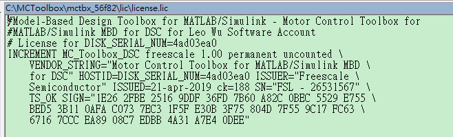

Hi NXP team,
I am using DSC  Motor Control Toolbox but encounter a license issue -5, dose any one can help me?
Here is license information :
MATLAB : 2014a
Disk ID : 4AD03EA0
Does anyone know what the problem is? Thanks for your help

constantinrazva
Hello [email protected]‌,
Can you share the path to the installation directory of the toolbox? And can you tell me if you have installed the toolbox on a shared drive ? Common problems with this are:
  • wrong disk id in the license
  • installation paths with spaces
  • installation on a shared drive - here there is usually some kind of firewall setup that is blocking the licensing system
  • local firewall
The first one you checked and it is ok, so this is why I'm looking for the other problems.

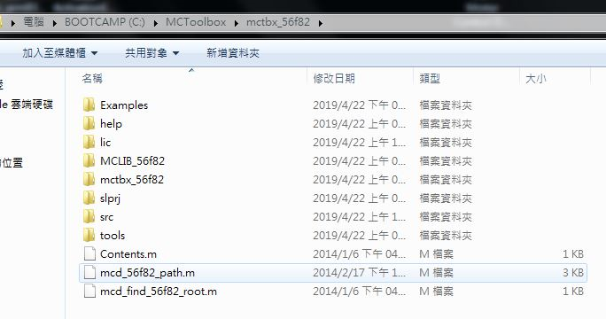

leo_wu
Hi Razvan
I have checked the item that you mention, as below
  • wrong disk id in the license -- checked before
  • installation paths with spaces -- no spaces : C:\MCToolbox\mctbx_56f82
  • installation on a shared drive - install on C, not shared drive
  • local firewall - I disabled windows firewall for MATLAB 2014a, still show license issue -5
below is my path to the installation directory of the toolbox
do you have other ways to fix this issue?
