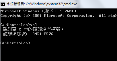

I put license file to C:\MCToolbox\mctbx_56f82\lic, when I run the build model, will show license error as below picture:
How can I fix this issue? I already reset the Set Path and reinstall the MC toolbox.
I see some information when I key vol on MATLAB:
Motor Control Development Toolbox for 56F82XXX        Version 1.0        (R2012a-R2013b)
My MATLAB is R2015a, is my MATLAB doesn't support Motor Control Development Toolbox for 56F82XXX?

For me the toolbox worked by copying the license to the DSC\src\lic but under development the path might be different. Please try in the following locations: C:\MCToolbox\mctbx_56f82\lic or C:\MCToolbox\lic but the most important is that the license extension must be changed to .lic. Probably it will not work with .dat file extension.

I have put license to C:\MCtoolbox\mctbx_56f82\lic as below :
but still can't use, as below picture
do you have any ideas?
