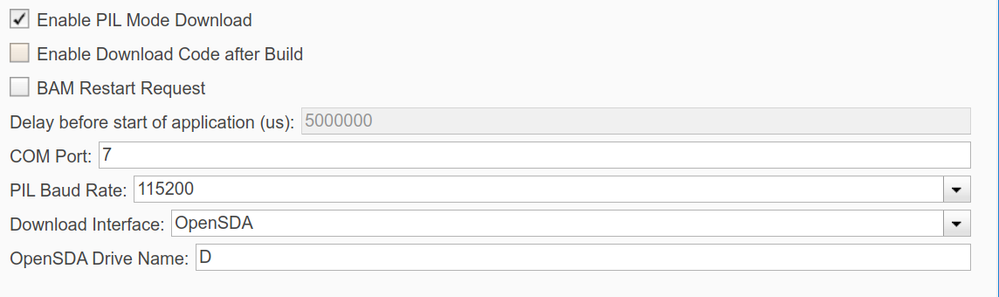

The PIL-config looks like this: config.PNG
Where COM7 is the OpenSDA-Port.

That's correct. The COM port is the one corresponding to the OpenSDA in the  Windows Device Manager, under Ports (COM & LPT) category. On my PC it is COM11.
The COM port is used for communication between Matlab and board during the PIL simulation. The OpenSDA Drive Name is used for the application download to the board.
You have to set the COM port and OpenSDA Drive Name in both models, PIL_Model.slx and PIL_verification.slx

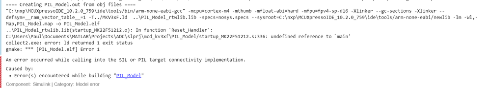

Thank you, I installed the HotFix and the error is indeed gone. But instead I now get this one:

tried again, got a different error again: "multiple target patterns":
I have attached the slprj-Folder again.

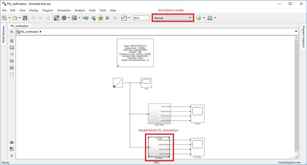

I am able to run your model and the pil example model from toolbox using the IAR compiler. I had to change the compiler from GCC to IAR and the simulation mode from PIL simulation to Normal simulation. When you are running a Model block PIL simulation (using a PIL simulation referenced model) you need to use the Normal simulation mode. You can read more here [1], [2], [3].

thanks for the update. I tried to run the attached files as you suggested but it fails. Please find attached the output of the Diagnostics Viewer.

Just to clarify: The COM-Port I choose should be the Port that is the OpenSDA on my PC right?
I have attached the Models, the slprj and the Output of the Diagnostics Viewer.

paulvlase‌ it is finally working now I forgot to update the "Child"-Model.
