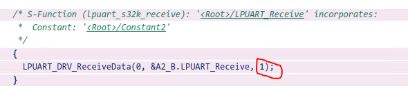

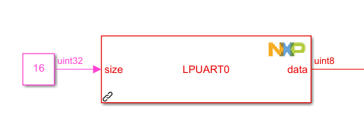

Hello all,
I'm trying to read 16 bytes from the serial interface, and I did the following comfiguration:
When I generate code, the function call is using 1 as size, and never changes:
Could you help me NXP team?

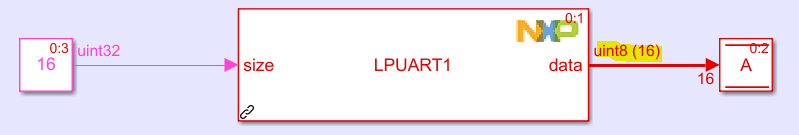

Hello [email protected]‌,
Even if the input is 16, the output is a single uint8_t variable.
I was more interested about the output data type, like in the following model:
In order to achieve this, please declare a Data Store memory and adjust the following settings:
You can declare it as volatile.
Hope this helps,
Marius

vinicius_olivei
Hello Marius-lucian Andrei,
Yeah, that is good work around
I created a stateflow chart which packes the buffer withing start character and end character, but your idea is better.
Vinicius.
