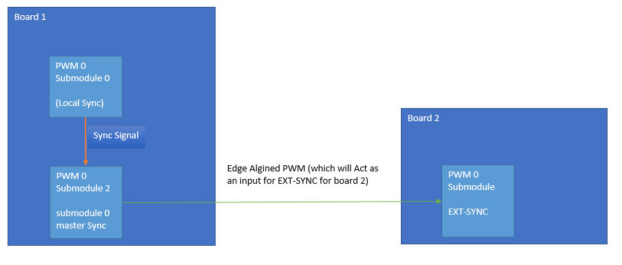

I tried to use EXT_SYNC for PWM0 module but without success. (for DEVKIT-MPC5744P)

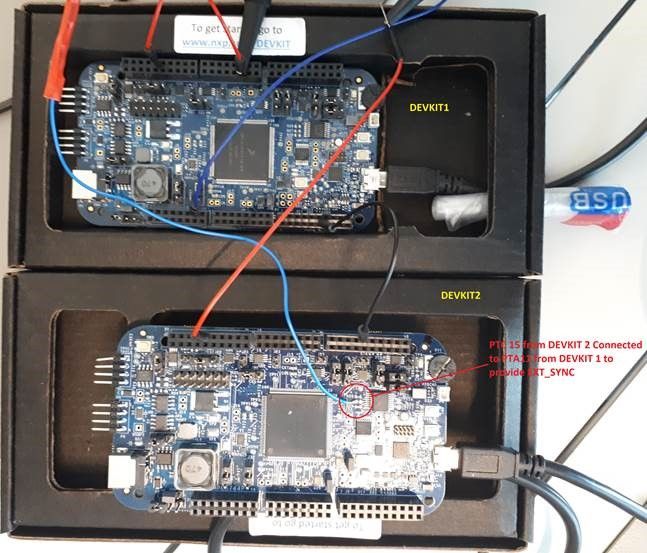

For this I created 2 models (for 2 different board, models are attached)
  1.       Syncro_PWM_CTU_External, which sends out a PWM and I use another PWM synchronized with the first one so it acts as EXT_SYNC signal for second board.

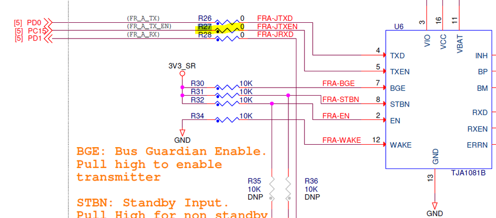

  2.       Syncro_PWM_CTU_External_Board2, I used CTU to have PTC15 as an EXT_SYNC Signal. (PTC 15 in DEVKIT was on F:EXRAY module so we removed R27 and used Micro Side Pad and soldered a cable)
Somehow the PWM in Syncro_PWM_CTU_External_Board2  (on DEVKIT 2) is not synchronized with Syncro_PWM_CTU_External(on DEVKIT 1)
Could you please suggest what is wrong in model “Syncro_PWM_CTU_External_Board2”?

So let's summarize a bit your status. As far as I know, you have obtained the sync between PWM0 and PWM1 on a single MPC controller without any external connection and successfully read 4 ADCs at the same time. Am I right?
Now, you need to sync the PWM0 module from one MPC5744P to PWM1 module from another MPC5744P?
I need to Sync PWM0 (of Board 1) to PWM0 (of Board 2), using EXT_SYNC of PWM0
Hope it is more clear.

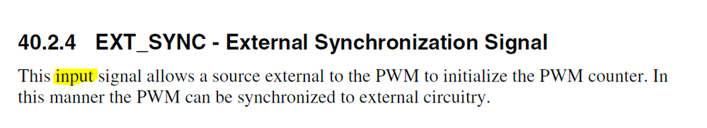

From the Reference Manual, I understand that the EXT_SYNC is an input signal. So basically now, you have two inputs connected together, with no signal to trigger them. So the PWM modules would be in sync together but you don't have a signal to sync their reload.

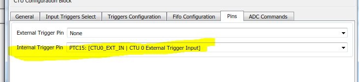

For PWM block, what the toolbox is not doing right now is to initialize the EXT_Sync pin as input for the PWM. So you need to insert some custom code in order to initialize the pin as EXT_SYNC for PWM. I would also try the following approach: Use the reload interrupt from the PWM0, BRD0 to toggle a pin and use it as input on the PWM0, BRD1.
What you could also try is to sync the CTUs from different board since the CTU blocks covers the external in and out pins under the "Pins" tab of the CTU.

I do something similar (as explained below)
I have 2 PWM submodules in Model 1 (Board 1), so I use the second PWM submodule only to send a signal (pulse) to Board 2 (ext-sync).
In the end, what I want is that to have the all  PWM of Board 1 in Sync with all PWM of Board 2. (just as we have in one board, i want in both boards and PWM0 allows that using EXT_SYNC)
I have done that in the model (Syncro_PWM_CTU_External_Board2)

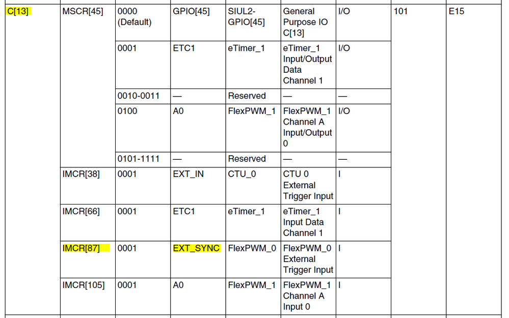

mariuslucianand
Hey [email protected]‌,
Regarding what you tried, to sync the modules, as I explained before, the EXT_SYNC pin from the Board 2 should be configured to be input for the PWM0 module. The MBDT now is not doing that initialization, so you need to insert some custom code in order to set PC13 as EXT_SYnc for FLexPWM_0 like in the screenshot added in my last reply.

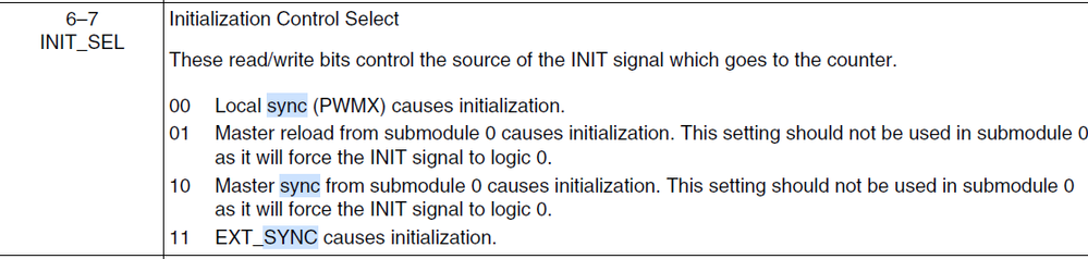

I am not able to find the SDK function call (to do INIT_SEL = 3, as in snapshot below), in S32 Design Studio.
Can you help me with this?
I tried searching INIT_SEL in search but can not find it.
FlexPWM0.SUB[0].CTRL2.B.INIT_SEL = 3;

mariuslucianand
Hello [email protected]‌,
The init_sel is performed by the pwm block, but the actual pin must be muxed to provide the actual pin signal to the pwm peripheral by writing in the Imcr[87] register and so on.

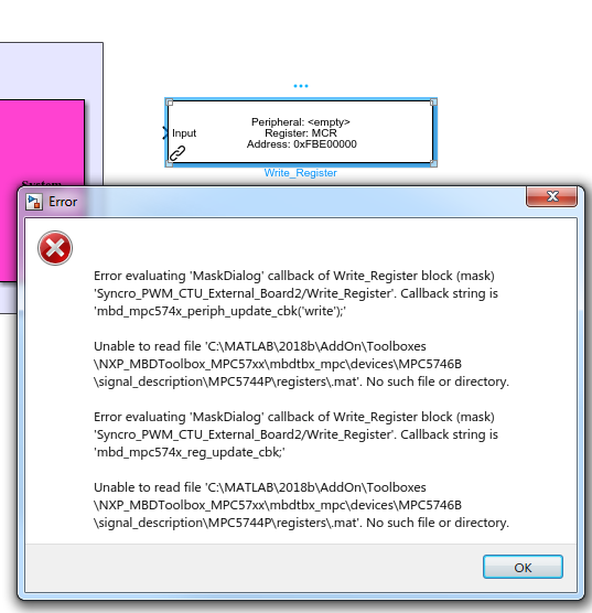

abhishek_kumar1
Dear mariuslucianandrei‌
Thank you for the hint but I am not able to use Write_Register block.
Also, I did not find IMCR registers here.
I think I am totally misunderstanding, what you are asking me to do.

mariuslucianand
We will investigate the error regarding the register.
However, in order to initialize the external pin to redirect the signal to the PWM0 you need to insert a custom code, declaring the structure attached tin the text file pwmSyncPinsCfg and then call the  two functions below the structure declaration.
If you need an example on how to insert the custom code, in our toolbox you will find a model called "custom_code.mdl". Consider adding the code from the attached file in the System Initialize block like in the model.
