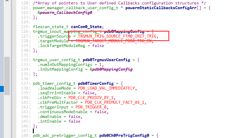

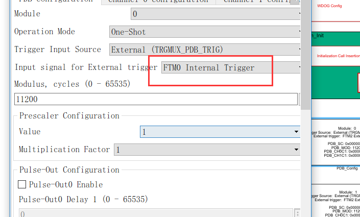

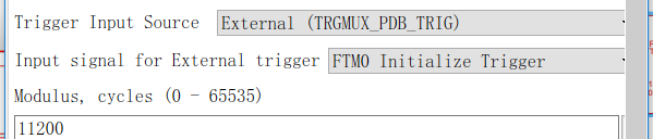

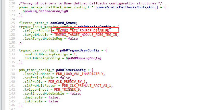

Sorry,When I rebuild MBD Prj,I Just find this:
1)when i use new mbd_s32k14_ec_toolbox.mdl & new mbd_s32k14_trgmux_get_trgsrc_enum.p(building errors):
2)when i use old mbd_s32k14_ec_toolbox.mdl & new mbd_s32k14_trgmux_get_trgsrc_enum.p(building normal):
