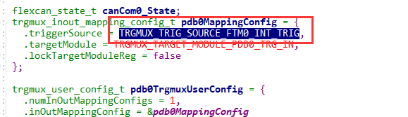

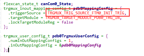

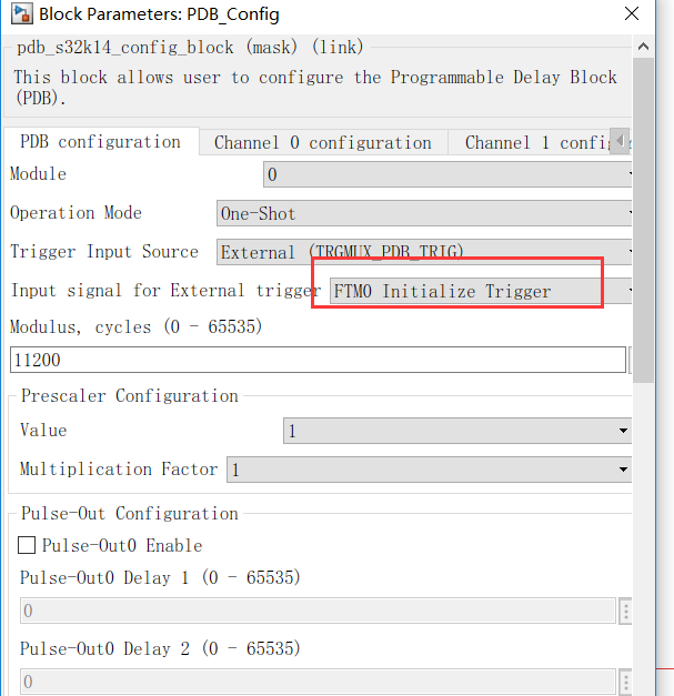

xmwang
There is not a single “I” here。
4,004 Views
mariuslucianand
Hello xmwang‌,
Thank you for reporting this issue.
Please try replacing the following files with the ones attached, but before that please make a backup for the existing ones.
{Toolbox install dir}\NXP_MBDToolbox_S32K1xx\code\mbdtbx_s32k14\mbdtbx_s32k14\ folder mbd_s32k14_ec_toolbox.mdl file
{Toolbox install dir}\NXP_MBDToolbox_S32K1xx\code\mbdtbx_s32k14\mbdtbx_s32k14\mscripts\pdb\ folder mbd_s32k14_trgmux_get_trgsrc_enum.p file
Please give us a feedback after you replaced the files.

xmwang
thank you ! this patch works fine

xmwang
Add this file “mbd_s32k14_trgmux_get_param.p”,It is OK!

Hi xmwang‌,
Thank you for reporting this issue to us. We confirm the existence of the bug which is now tracked as AST-897
We are working on a patch and will make it available tomorrow: January 9th 2018.
