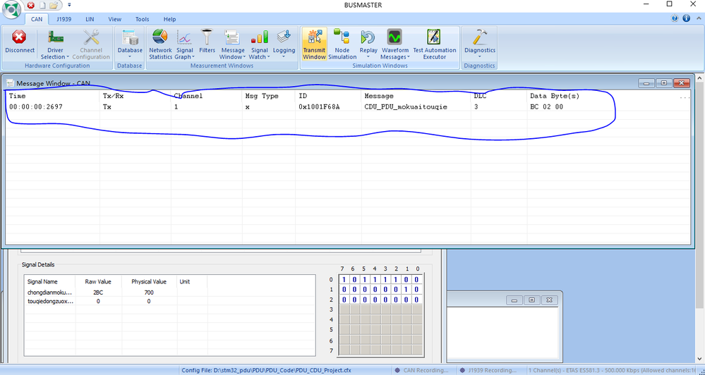

hongjinzeng
After I download the can_simple_block.mdl to the controller,then I use busmaster to observe the message.The message I can receive in the window.
