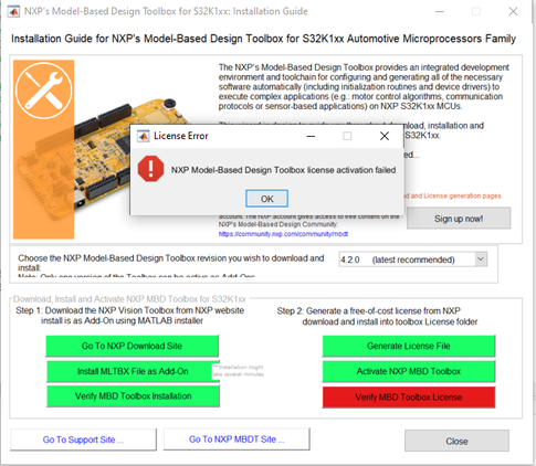

I was trying to download and verify NXP S32K MBDT toolbox, I am gettin this issue.
 License Error: -1, Model-Based Design Toolbox License Missing, please go to The Model-Based Design Development Toolbox Web Site to get a free license or request a demo. Provide the following HostID.
What is HostID?
We have followed this video: https://community.nxp.com/t5/NXP-Model-Based-Design-Tools/Model-Based-Design-Toolbox-Quick-Install-G...
Thank you
Anyone please comment on how to resolve this issue?

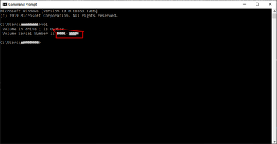

The HostID is the Volume Serial Number for your volume partition.
To get this id XXXX-XXXX you have to open a Command Prompt and type the "vol" command, as below.

srikar_26
We have generated the HostID as per the video, but we are still getting the same License error.
