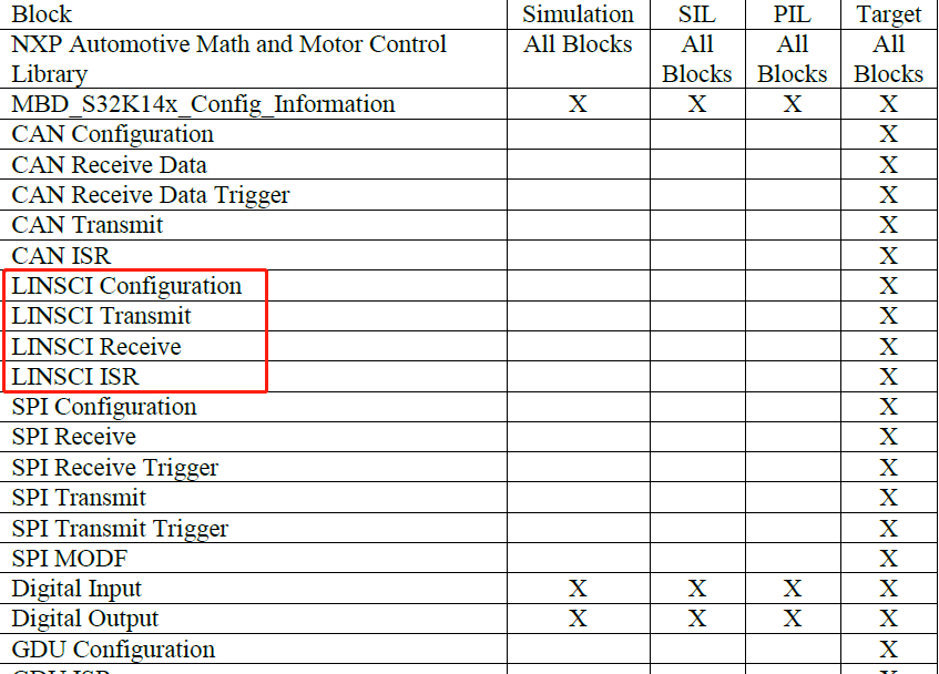

Using Model-based design toolbox in simulink .but there was no LIN model ,check the  <<MBDT-User-Manual-for-S32K>>, there is LINSCI block like below.But in the document ,there is no LIN function or block ,why is that? Is LINSCI not the the LIN-BUS that we known?

In the MBDT for S32K we support SCI (Serial Communications Interface) via the LPUART blocks (Low Power Universal Asynchronous Receiver/Transmitter). However, we do not support LIN bus - that is another (software) layer that comes on top of the classic UART. LIN's data link layer provides improved control and error checking over a UART interface and has fixed format message frames.

Note: this thread was started some time ago, in the meanwhile we have also added LIN support for S32K1xx toolbox.

You can use the LIN example model (lin_master_s32k14x.mdl) -- just open it (found in {TOOLBOX_ROOT}\S32_Examples\s32k14x\lin folder) and click on the Build button. This will generate the C files, compile them and you'll get the executable. Depending on the settings from the main configuration block, you could also download the executable file directly from Simulink automatically (right after the build is done).
